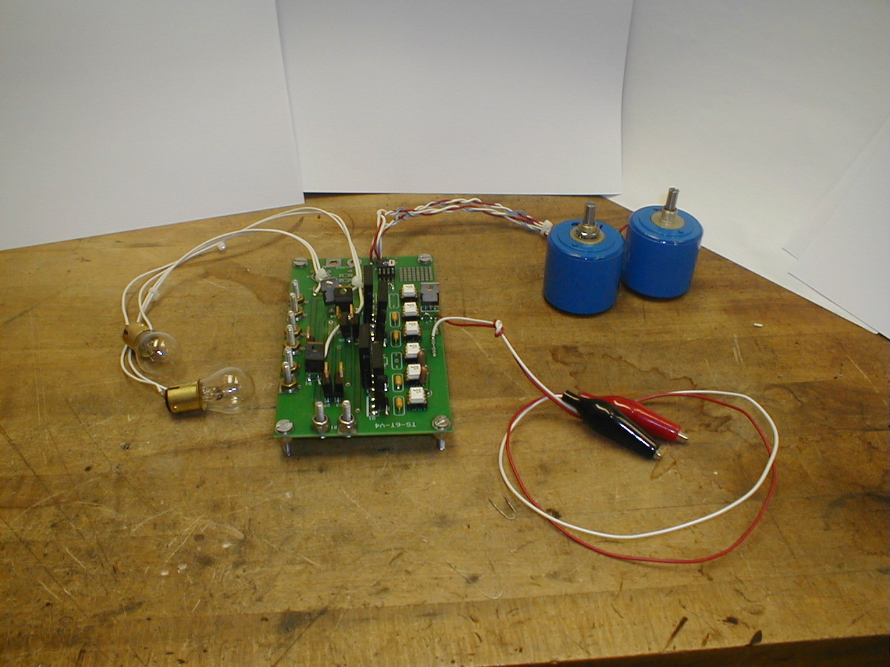

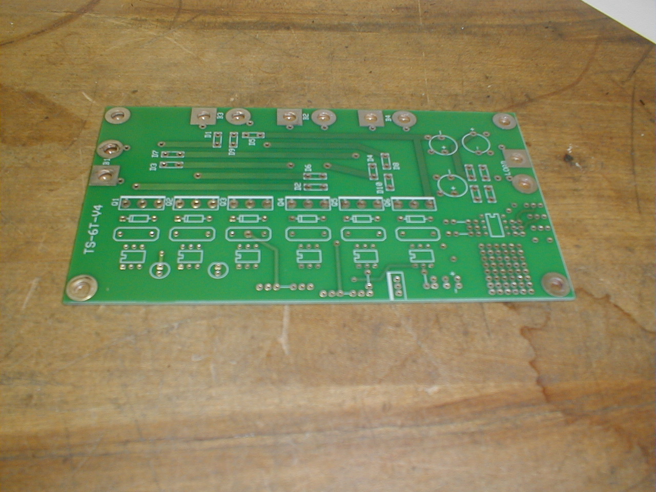

                              • Tesla Switch Project
                                Hi everyone
                                I redrew the Mueller circuit to use Optos, the MJL21194 transistors and a PIC12C671 (left over from a project to block telemarketers..) to do the switching using 2 of the A to D inputs to change the pulse on width and off delay (TS-4ca.pdf). I had a PC board made with lots of possible options (I hope!). After Bit's success, I modified the circuit to equal his (I think..) and built both a 6 transister version and a copy of Bit's 4 transistor version.
                                Please note that the labels on the board of the transistors is wrong - Q1 and Q6 are correct but the rest should be Q1 - Q3 - Q5 - Q2 - Q4 - Q6. I also got the part spacing wrong (too close) so I can't use a one piece heat sink.
                                I chose to power the PIC with a separate source until it was working. 2 5K/10 turn pots are connected to the A/D inputs. The 6 optos are set up as 2 banks of 3, in series and turned on by 2 outputs from the PIC. I initially had an LED in series with each set of optos but first tests indicated the optos were not switching full on so I replaced them with 50 ohm resistors which limited the draw from the PIC to 20ma. each bank. The pulse width is adjustable in about 5ms steps from about 0 to over 1.5 seconds and the delay is from 0 to 200ms currently.
                                I have only tested the 4 transistor version so far. The bulbs glow dimly and the pulse width can definitely be varied. However, with a good set of batteries, I show on a digital voltmeter placed on the (+) of B1 and the (-) of B3 18 volts in series and 12 in parallel and the transistors get very warm.
                                No net gain on the batteries.
                                Hopefully I will get some more testing in next week..
