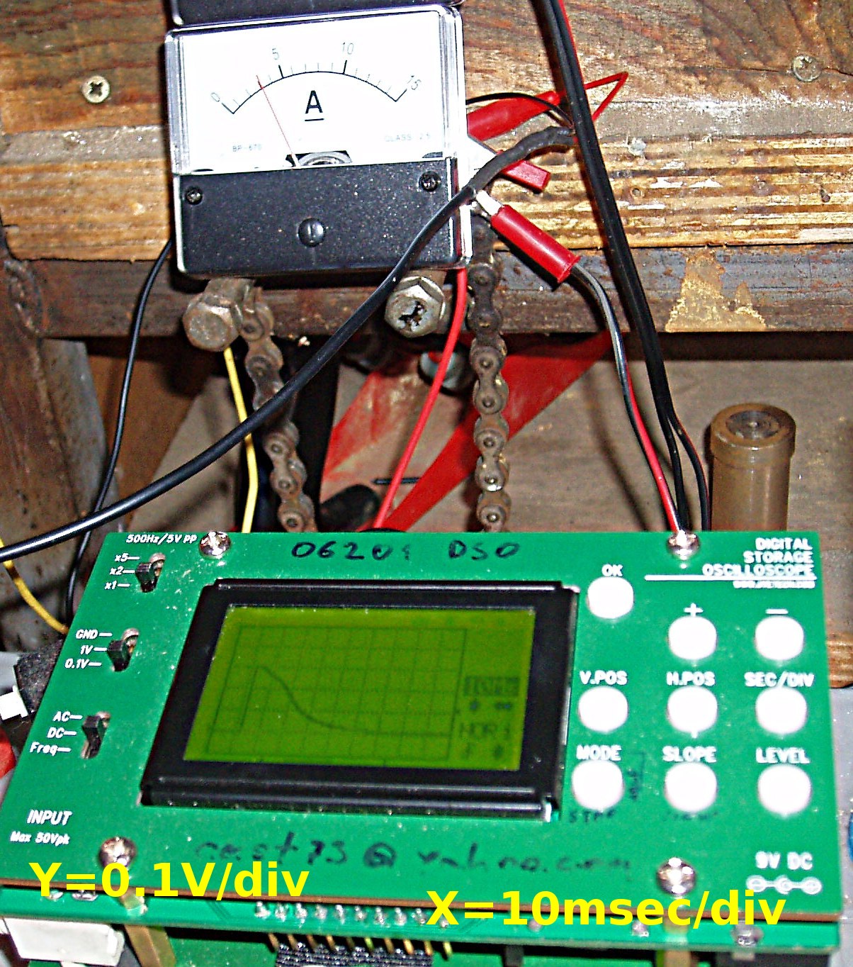

As I do not have a adjustable power supply I had to limit the input with the pulse width of the picaxe.My input is a 20V, 8a notebook power supply and I had to limit the input to 3A on the ammeter with a 60msec pulse from the picaxe. The output pulse is also 60 msec as I found that is adequate time for the caps to discharge into the battery.
I tried what you said but only found that the input current went up and the output stayed about the same. When I shorted both the negative transistors the BD140 on the serial transistor blew up and I stopped the experiment.
