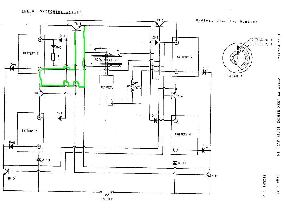

          Furthermore, look at the picture of the erroneous schematic. As indicated in green, as it is drawn, there is no possible way to turn TR1 on, and even if you could, you would only short circuit Battery 1. Using a transformer coil allows you to decouple all the bases and emitters, and instead apply a small transient forward-biasing voltage between the base and emitter of a single transistor independent of the powering source. See here for a similar circuit: Magnet Motor - Kicker.

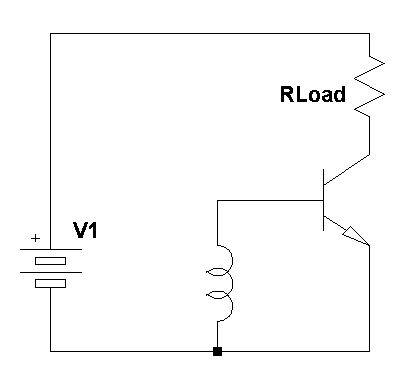

          In the second diagram I have simplified the arrangement to it's barest minimum to illustrate that you only need an appropriate voltage between base and emitter to cause the transistor to turn on. This is exactly the same way Bedini uses a trigger winding in the SSG to turn on the transistor. The NPN transistor will only turn on with "positive" voltages applied, i.e. the base is at a higher potential than the emitter. With a negative potential, the transistor stays off. So long as you induce the coil in some way, (moving a magnet past it, or an inductively coupled electromagnetic pulse), a positive-going voltage can forward bias the transistor, while a negative-going voltage pulse won't do anything. This method allows the powering source to REMAIN ISOLATED from the forward bias voltage. (See the Ken Moore T-7 diagram.)
          The "other way" to forward bias a transistor is to "pull the base up" to the collector potential. This is the way the opto-couplers work in the Cole Bipolar Switch. It amounts to same thing, namely applying a positive voltage difference to the base with respect to the emitter, EXCEPT that this method uses the powering source to ALSO supply the forward bias voltage.

                          For the moment I'm going to set aside the forward-bias issue of the transistor.
                          I don't want to let my OCD get in the way of progress either, but I still think there's something wrong with the circuit diagram. Let me explain:
                          If I "take that and duplicate it in both directions" by copying the right side connections to the left side batteries like the picture below, as soon as the transistor turns on, will it not short circuit both left-side batteries since there is nothing to break the parallel connection?
                          I propose that redeagle's picture (post 309) is accurate. Look at the picture below, the one with Figures 1, 2, and 3. In figure 1, I show the relocation of the two transistors from your drawing such that they allow an interruption of the parallel connection of the right-side batteries. This allows the circuit to be "duplicated in both directions while avoiding the short-circuit condition I spoke of.
                          But also note, that by simplifying the diagram further, and putting diodes in instead of transistors, you can see that figure 2 is still an open circuit. By reversing the left-side diode (Figure 3) you make a circuit which can function. This circuit is only one half of the final circuit. The second half reverses the flow through the load.
                          By noting the direction of the diode in figure 3, I return to my original postulation, and reiterate that redeagle's diagram must be correct.
                          Yes? No?

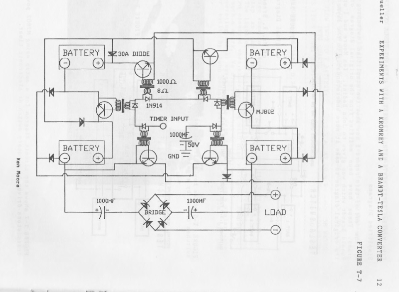

                            in the mueller report figure T-7 on page 12 if you start ate the timer input and go clock wise labeling the transistors 1 to 6 then as wired 1, 2, and 3 fire then the other 3 fire. Transistors 2 and 3 put the left bank in series. While transistor one is intended to parallel the other bank, it actually creates a short. It is shown to connect the negative of the first battery on the left side to between the negative diodes on the right hand side. Because at the time there is positive potential at that diode the current shorts and you have a smoking mess.
                            As far as i can tell the switching in figure T-6 is correct if you follow it you should be fine as far the switching goes.
