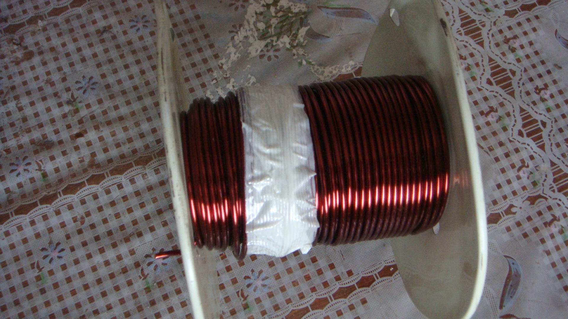

Hi David
ya indeed you wer[QUOTE=Turion;162823]ehsanco 1062
Hi David
Yes indeed you were.
I also got this morning my #10 AWG wire and when I looked at it I was just like what the hell !the wire is too strong to warped only wire how about three wire so i think i did mistake by ordering 10AWG wire I should order 14 AWG which i couldn’t find in the place where I make my order and here in Sweden nothing you can find the wire ,the transformer ,the 1 farad capacitor ,basic stamp so i order all these parts from USA and I pay for shipment and taxes in USA and I also pay taxes here when I receive the order for example I pay today for only the 120" wire 67$ can you imagine and i pay 128$ for shipping the transformer and i pay here 75$ so only the transformer cost me 270$and the wire 200$ i just mention these number because i remember you said before big one will cost 600$ i wish it will cost me that number i thing bill will be over 1100$ and i am satisfied with that if i can do it right.
