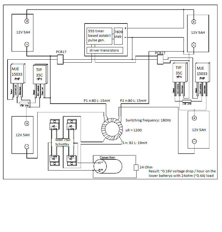

                        • The rewire of my toroid was done, i simply cut down 1.5 meter wireing from all the coils, now thanx to the reduced inductance my toroid can work optimaly on 200+ Hz.
                          But this changed nothing, with 0.4A load, the lower batterys are simply draining with a rate of 0.16V / hour.
                          I attached my current setup, what's still wrong with it? I'm out of options.
                          • Originally posted by Kepszlok View Post
                            You know what it could be is the timer circuit is not allowing any off time. So the transistors for a limited time may be shorting the system. With IC you clearly turn off the pin then turn on the next but this may not be happening with the 555. You may inadvertently be turning both side for just a brief period and causing a dead short. Really quickly though may be hard to notice.
                            That would also account for the problems you were having with heat before. I have never done it the way you are doing it so I cannot speak for it.
                            Matt
                            • Originally posted by Matthew Jones View Post
                              Matt
                              Hmm, it's possible. A 74HC74 DFliplfop creates the Q and Q- outputs from the 555's pulses.
                              Between the switches, there are a 10V high spike on the scope when it's connected on one of the 150ohm base resistors. (same on both)
                              I have hardware to make the switching custsomizable, but it's need some programming.
                                So let me go into some detail on this. I may be wrong but from what I am seeing what I am explaining is probably the problem.
                                In the drawing you post under the 555 timer you have "Driver Transistors". This is where the problem is. You are most likely using an NPN to turn on from high signal, and PNP to turn on the low.
                                I do not know what power level your using through your 55 but 12 volt is most likely.
                                So picture what I am telling you.
                                The NPN is ON to drive one side. You have 12 volt on the base of the NPN to keep it ON and hold the PNP OFF.
                                Now your signal goes LOW, but it take time even if it seems fast it takes time. The NPN will not shut off until you are around .5 volt on the signal. The PNP turns ON as soon as you .5 volt of difference between the signal and the power on the Emitter. Current can start to flow.
                                Think about what I am telling you.
                                During the transition between HIGH and LOW, both transistors are on. So are the transistors between the batteries. You had big heat problems I did not follow that earlier because I did not know how your were driving this.
                                You should be using a 556 so you can isolate the signals from side to side and make sure the duty cycle incorporates small off times. Or use an IC as recommended.
                                I hope that helps let me know if you do not understand. I really am greatful your still working on it.
