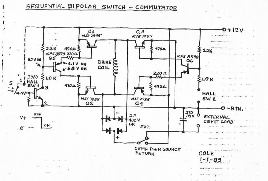

                • Tesla Switch
                  Yes
                  This is the circuit, but rick has taken out the Hall device, I think I have a PDF
                  I will post.
                  JB

                        • Tesla Switch
                          Here is the right drawing for the switch, it shows where the hall devices go.
                          JB

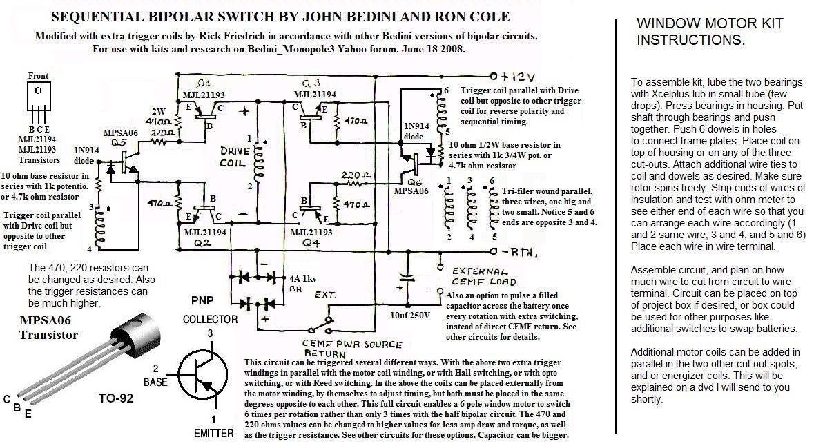

                            • Tesla Switch
                              Ren,
                              If you use this put a reed in place of the Hall or use optical. Leave the 1K
                              also protect the hall positive voltage buy using a 470 resistor and a Zener diode to ground. That way you can never blow the hall out. Use this diagram only.
                              It's a fast little devil.
                              JB
