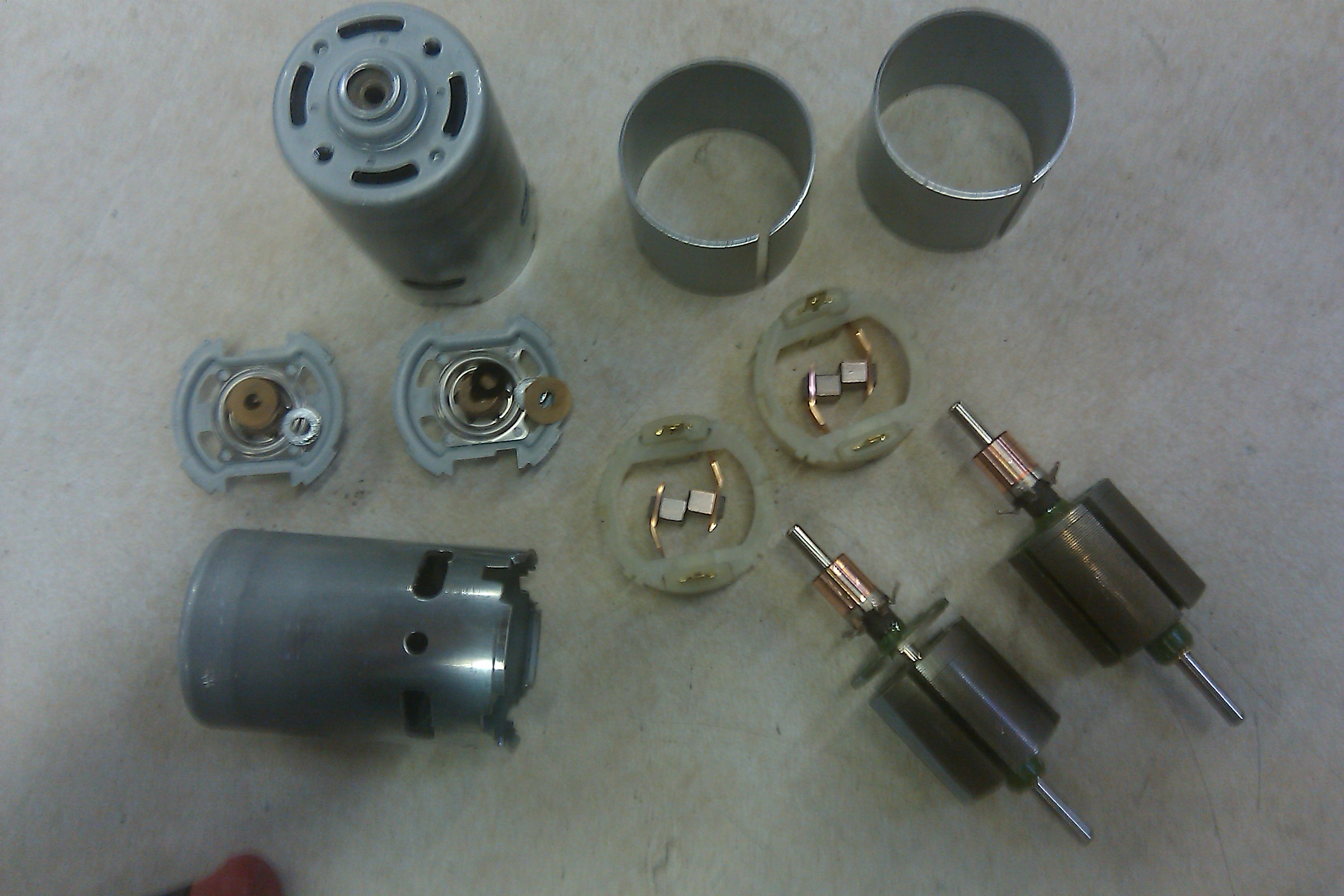

                          • Ready to Wind
                            Thanks for all the info UFO, Great work on all the videos.
                            I purchased some similar small motors to the RS, although it maybe a little larger,
                            same five pole conf. and I am going to cut off the end of the second motor
                            and weld it to the first. (picture below)
                            The picture you posted, of yours, is a little vague on the windings, as it appears one
                            coil wraps on two poles.
                            I drew it out and looks like each pole has two windings around it, as left of one
                            winding and right side of the other winding.
                            CCW direction for us northern hemisphere.. Right.
                            Can you please clearify, for all of us.
                            Thanks, Mark
                            • Hi Rl2003, the armature coil does wrap around 2 of the poles, then continue wrapping when done with that coil to the right or left, whichever direction you are choosing, start winding another coil over the next 2 poles to create the typical north on one end and south on other end.
                              These 2 coils are in series and will look like a pyramid or V shape when looking down shaft.
                              Hope that helps, as I intently studied all his videos and pictures and words.
                              peace love light
                              tyson
                                Unfortunately John, yes, motors have to be stripped off all wires, clean...The Symmetry most popular winding is the "Lap winding"...where Coils are all connected in a continuous loop and just passing by the commutator hooks to "bite them", they have very little turns (since from end to end of brushes it adds up since they are in series...That is a reason why Motors should be chosen as not having the heavy epoxy resin in wiring...it could become a nightmare...and more complicated process...some people boil them to strip them..The way to build a Motor the right way...after winding it, to epoxy high temp it, then get them in a vacuum chamber...so all the resin is impregnated deep inside compacting all wires to the Core...avoiding vibrations and damping noise...so, must of times is better a cheaper motor...that was built without that expensive procedure.
                                Here is a document explaining a/o "lap winding" and explains that the coils are indeed put in series:
                                http://ecourses.vtu.ac.in/nptel/cour...(EE)NPTEL).pdf
                                (copy: http://www.tuks.nl/pdf/Reference_Mat...ings%20etc.pdf )
                                Double layer lap or wave windings are generally used for armature. Essentially all the armature coils are connected in series forming a closed armature circuit. However as the coils are distributed, the resultant voltage acting in the closed path is zero thereby ensuring no circulating current in the armature. The junctions of two consecutive coils are terminated on to the commutator segments.
