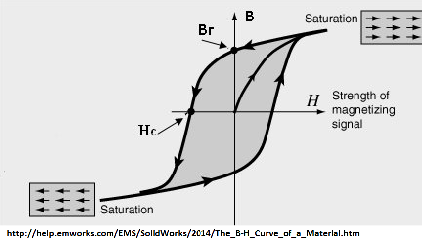

                    Hi sam,
                    Well, I'm glad that is resolved. I was kinda worried about remag when I saw you stick the compass inside the PM stator. Inside, between the 2 magnet sectors there is quite a strong B field enhanced with the outer steel tube. If the compass is inserted quickly, the field latches onto the pointer whichever way it is directed and imposes its own polarity. From there, due to strength and size, the field in the steel compass pointer is driven into magnetic saturation (or thereabouts) reversed from its original magnetization direction. Once removed from the stator, the steel in the compass pointer settles to the residual of the opposite polarity (from the original) and the compass is now seeking the S geo pole instead of N.
                    See the B-H curve above. The compass pointer steel originally is at Br and works in quadrant II. After the remagnetization, the steel is at -Br and works in quadrant IV. I think I got that right. Been a long time since I used B-H stuff.
                    Oh, I wanted to say. You may be able to remag your compass back to normal by getting it into the stator pointing the other way. Perhaps use a small magnet to keep it pointed until you can get it inside the stator.
                    Regards.

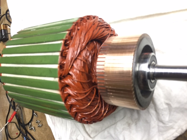

                          • P66 Armature Wind
                            Ready to be taken to a motor rewind shop for balancing. (at last...)
                            glenWV
                            • Originally posted by GlenWV View Post
                              glenWV
                              WOW Glen, Beautiful job, your my hero.
                              Warmest Regards Cornboy.
