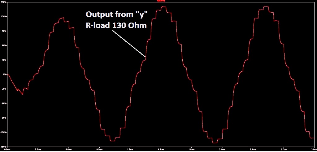

  • Ufopolitics
    The same sim. as in my post #1265 but the G-part consists here of pure resistors with different values. Scope shot => OUT (y)
    Less power factor 38% and output voltage 135V p-p.
    Only a 1/3:rd of OU
    Arne
    Seaad,
    That sim is not good, the signal can not even reach zero point, (always on positive side) much less passing zero like that getting 50% negative values.
    Take care

  • seaad
    LT spice XVII simulation G-part ONLY RESISTORS
    Only a 1/3:rd of OU
    Arne
