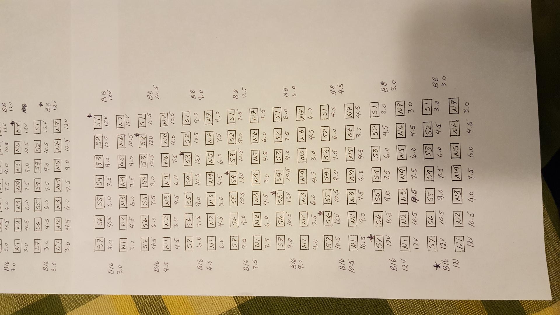

      • Attached are the theoretical values if the coil resistance is 1.5 volts of resistance per coil. GREY WOLF

          • Bi, the charts I sent above shows that the lowest voltage only drops to 3 volts so there should be no polarity change. The current is always in the same direction. If you map it out, you will see a distinct strenghten of the N 4 coil while the S 4 coil is weak and a half revolution shows a reversal with the S4 strong and the N4 weak.At the 90 degrees of the commutator the S1 and N1 fluctuate the same way. There are 4 high-low pulses per revolution of the commutator brush.
                    Hi Grey Wolf,
                    You need to do circuit analysis for each position of the brush around all 16 segments. The current will flow according to the principals defined by Kirrchoff. One thing for sure is current will flow in the path of least resistance along with other paths which have higher resistance.
                    I think you overlooked possible paths or circuits in your analysis. For example, when the brush is on segment #2. So positive (+) supply voltage is connected to wire N2. That connects to both coils N1 & N2. Thru N2 to N3 to N4 to N5 to N6 to N7 and then to supply negative (-). Coils N2 thru N7 all have the same polarity. There exists another path back at the node between N1 & N2. Here the current will flow thru N1 to the node connecting segments #1, #16 & #15. From there it will continue to flow thru wire S7 to coil S7 and onto supply negative (-). This current will cause polarity of coil N1 to be opposite from coils N2 - N7. Coils N1 and S7 will be at least 3 times stronger than any others.
                    There is also a loop where coils S1-S6 are in parallel with coil N7.
                    This is an incomplete analysis but intended to show major issues with your connection scheme. This is intended to help you analyze the circuit. No offense is intended.

                      • Bi, thanks for the analysis. No offence taken. I will analyze each of 16 contacts and chart that for you.
