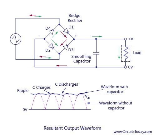

The cap is primarily a filter on the bridge rectifier plus aiding the establishment of residual if needed.
{edit}
Maybe just difference in terminology, but the field (rotor) runs at a steady DC from the bridge and cap. Didn't you take the current and voltage a while back. What you get is a steady N pole on the rotor (field) sweeping the armature coils (in the stator slots) followed by the S pole on the rotor. This induces (generates) AC in the armature (stator winding). I'm at a loss as to what is charging and discharging at 90°.
