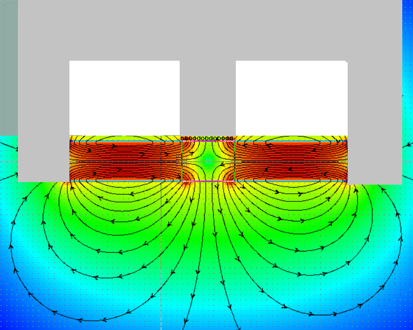

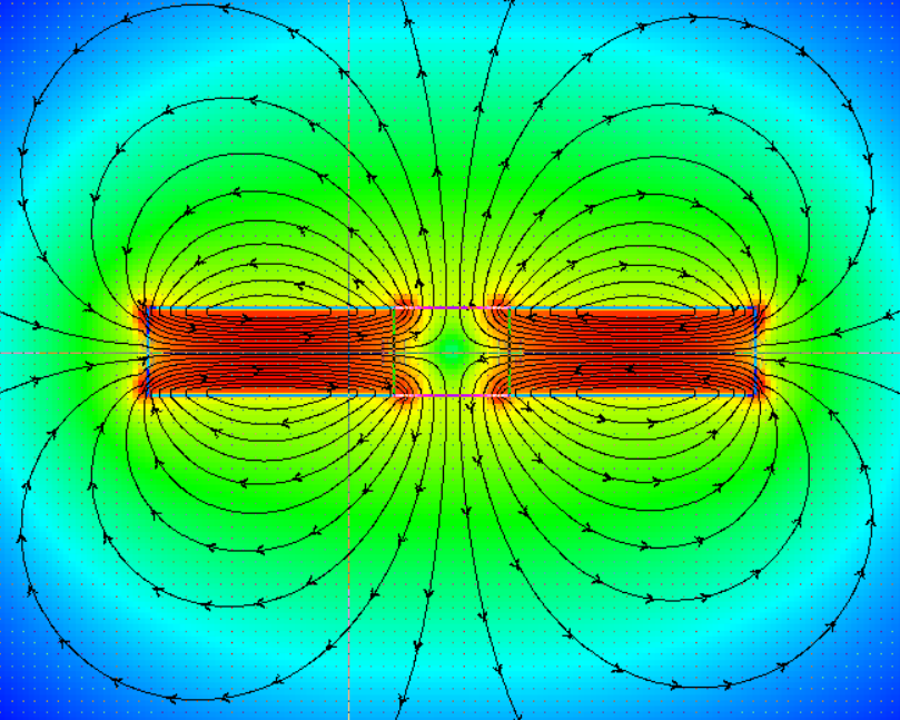

  • bistander
    E-core backiron
    Hi hanon,
    The tube you show is not what I had in mind with E-core. I'll try to get a diagram with better explanation.
    O.K. So I gave it a shot and took CM's simulation:
    And added an E-core:
    Yeah, I know. Not too good with the graphics. But hopefully you can get the idea. I think to use just one section of E-core lamination stack where the cross sectional area is equal to that of the core thru the coils. This way, all the flux from each end of the core thru the coils can go thru the backiron (E-core) to the center leg and there downward thru the seconday coil turns into its core and complete its circuit. The flux lines would cut the secondary conductors at quadrature like I've been telling Ufo they do in generators. The void areas in the E-core (shown in white) represent high reluctance paths and will direct maximum flux where you want it; crossing the secondary coil.
    Just an idea. Use it or lose it.
