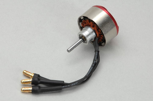

hi dave. i haven't tried it yet.it looks like these motors start at about 10 dollars with shipping from china on ebay.hobby stores might sell them for not a lot more.
it comes down to separating the windings at the Y junction and mounting a reliable terminal for the 3 additional wires.
normally motor efficiency with these is around 70-85%. if the proposed timing scheme can run these motors and if it can double that efficiency,then we will have something to play with.
some new pancake axial flux motors are said to be 95-98% efficient.over time these will probably make a better motor/energizer,but for now,bldc rc motors are common and affordable.and the required modification shouldn't be too hard,less so if you have experience modifying computer fans.it depends on whether the 3 wire connection can be got at sufficiently to separate/isolate the phases or add a 4th wire for a center tap.and then room for mounting an extra wire or 3 wire terminal and leading out the wires.if it helps,it looks like removing a circlip at the back of the shaft allows the motor to be separated.this might not be necessary,but if you do it watch for washers inside and out,and reassemble the same. here's a pic of one model with great access to the windings.
i'm confident that they will run well with the mod and the proposed timing system,but the proof is in actually building and evaluating it.

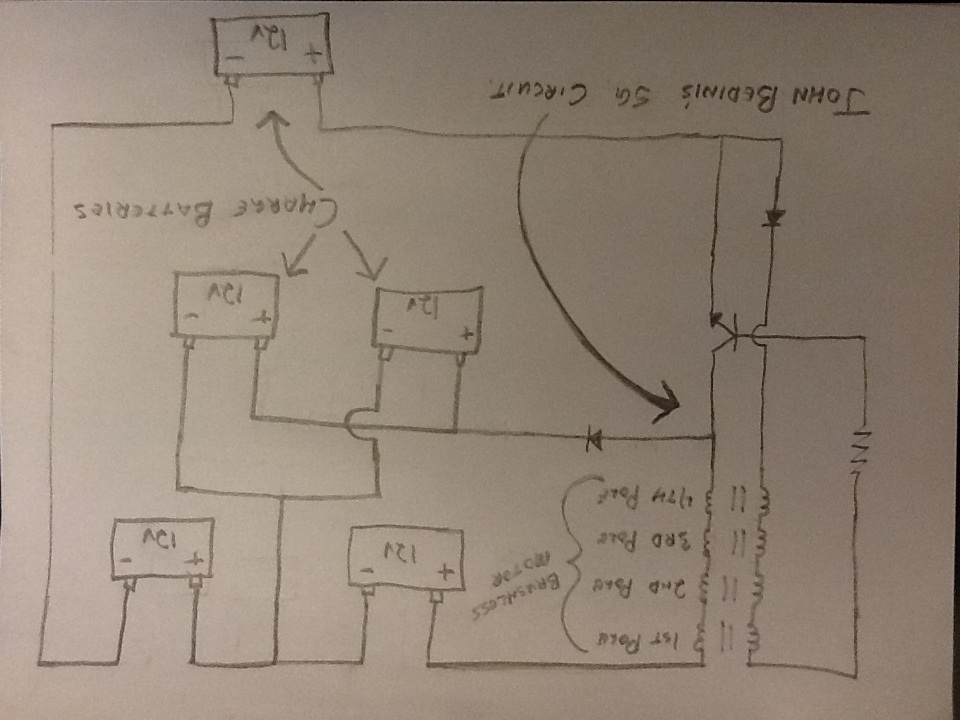

The brushless motor is out of a HP 5550 printer, there are 8 magnetic poles around the rotor, alternating north and south. The stator has 12 poles, I wound two wire lengths (one for a trigger and the other for the power winding) around 4 stator poles, so the four coils are wound in series. Resistance is low because you cannot fit much wire on all the stator pole pieces, I simply filled each pole piece to maximum fill and did not count my turns. You can find these brushless motors on eBay, look under printer motors or even look for a brushless washing machine motor... If you want something bigger to play with. See pics below

Don't know why I could not post more than one pic from my ipad... So I posted again. The pic below corresponds to my previous post, it shows the configuation of the small brushless motor. I run that same brushless motor in John Bedini's Gen mode as well. The possibilities of this system are great and need to be explored further. If one can grasp all this in its simplicity a mechanical tesla switch may be envisioned???

What is the difference when you go series? I could try this on my SSSG units. Does it raise the voltage or what? Nice setup
Mikey
Hi Mikey,
Series will lower amp draw, provide better primary and secondary charging and raise torque to a degree... I doubt I have 10 feet of wire wound on that brushless motor FYI. One more pic then... I will not post my stuff here on this thread any longer as I do not want to hijack this thread.Attached FilesLast edited by jettis; 12-09-2014, 06:44 PM.
Hijacking thread
I wouldn't say posting about a pulse motor or a Bedini motor modification is hijacking the thread. After all, we are looking for the BEST pulse motor design as one of the component pieces to a basic device.

hi all. it might be worth evaluating these rc motors as an energizer as well.they are a 3 phase ac motor,with pm's, so rectified like an automotive alternator,one of these could go well.or maybe 2 of them...
interesting to note some of the RC guys are into this.here's 1 account.The Kv needs to be matched to the expected generator rpm and desired output voltage. Don't choose your motor(s) until you have determined these parameters! A 650Kv motor needs be driven at ~10000rpm to get 12VDC out under load (taking into account motor and rectifier losses).pic 3 shows the motor referred to.kv means no load rpm/volt input.so maybe,to hook 2 of these together the motor kv needs to be higher than the energizer kv, for a matched motor-gen combo for general efficiency or trying to loop.
there's a fair bit of info on rewinding these motors in the rc forums as well.
