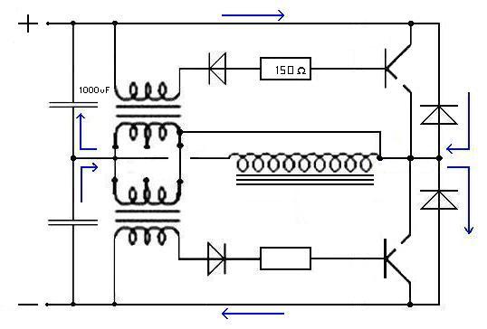

                      • hi all.doing a bit of reading lately has renewed my interest in regauging EM cores in a motor.so i tried a dual polarity power supply for a bit of push-pull.then i noticed that i could loop the spikes back to source,(to the other big cap from the 1 that just switched off).it just fell into place.here's a way to loop with a mono winding.i guess the internal diode in fets in regular push-pull circuits does the same thing when switching inductors,which can be 2 coils with a center tap,like the pic in post 432,or a motor winding. i guess sometimes it get's wasted.at any switch-off point the other transistor is always off as there's a short interval between events.this is on the rc motor 1 phase ac. it runs pretty smooth and quiet and has decent torque for 2 coils in a motor with room for 12.
                        i'm thinkin, with more volts or less turns, more speed/shorter pulses the spike recovery should refund a progressively higher % of input.after measuring the returns it looks like the switch-offs could be sharper,maybe earlier. in a blocking osc. the feedback winding speeds up the switching on and off.that might be what's missing in this setup.i guess this is where fets and drivers go better.this circuit is a work in progress.will see what i can do with it.
