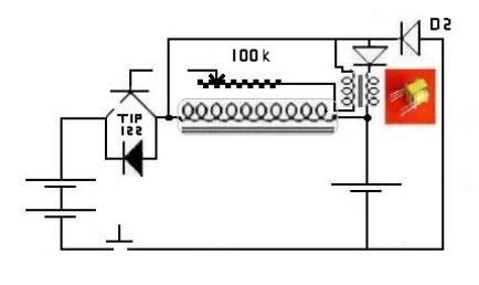

    • hi all. i haven't got much to play with,so far i have charged some batteries with the circuit in pic 1, running a spindle motor at about 100 ma, not much. early observations suggest that the charging batt/s sorta dictate/regulate the voltage across it/them.and the motor presumably runs at the supply voltage minus the charge batt. voltage. apologies matt or dave if it's a wrong assumption. it's a bit of a guess as it's too spiky to measure the charge batts voltage with the motor running/pulsing, on my tired and possibly getting flaky dmm. the motor winding has a dcr of 2.6 ohms. this circuit is a bit like the re-emf circuit, which is a solid state version, but the load is between the pos's here and the spike recovery looks good on this too. i will add a 50 ma old school needle type ammeter in the spike return line. i tried some other brushless motors and this 1 kicks on switch-off the best but it still may not amount to much.** have seen 28ma on the meter.as thats a steady average of pulsed spikes, it's significant.
      tip 122's have that diode built in. has no effect, i presume. vr1 makes starting/tweaking for max rpm easier.yellow box is a mini isolation transformer.
      presumably it could/should have 1 or 2 batt's and a boost module on the left instead of as in the diagram.

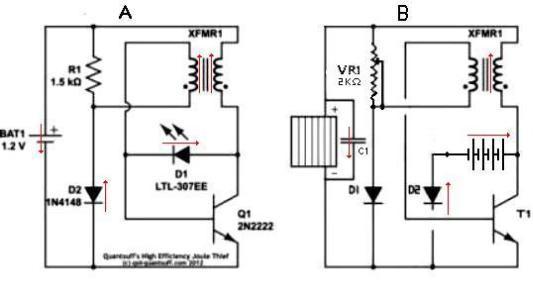

      pic 3a is a neat little joule thief inverter, by mr quantsuff. it's more efficient than most j.t's. 3b is slightly modded. hopefuly, brushless motors and flea power isn't too off topic. i guess whether you deal in milliamps or amps, the principles to study and learn are still the same.
      cheers.

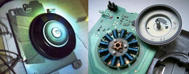

      • Alternative cheap motor
        I have a couple of these car radiator fan motor. They also have 4 magnets inside.
        Mabe we can use it for the Matt modification?? What do you think of it?
                    That looks like it will work but it have a few more poles so you'll have to guess the adjustments. Shouldn't be a biggy.
