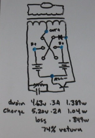

          While waiting for the MPPT, a past project has been resurrected. To be honest it was never thought to be anything more than a novelty for extending the run time of JT circuits. It appears I was being a bit short sited...
          Over the last couple days it's shown me that it might be possible to bring it up into a power level that would provide a useful output, although, as the output power goes up so do the challenges. However, it does meet the criteria of my end goal.

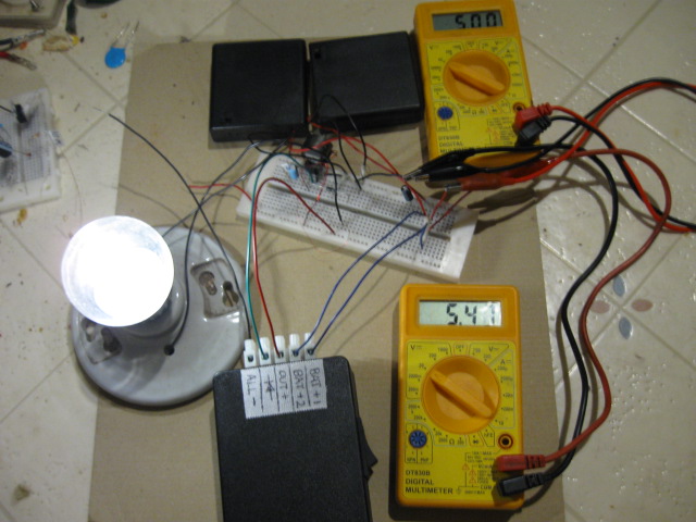

          The picture shows a small Hartley circuit driving a 120v 3watt LED bulb utilizing a switch circuit to drain one bank and charge the next - when one bank is charged it can be switched back to reverse the process. I had never done any real measuring of the circuit - simply running it for days on end to see how long it would last...
          To my surprise it was returning 74% of the energy... really close to my 80% acceptable range. So to put that into perspective if you were running a 10ah load, 7.5 ah is being returned, effectively running a 10 amp load with only a 2.5 amp loss. So I'm thinking if I can simply toss a project like this together with little thought with this much return I should be able to surpass the 80% with a little thought.
          The circuit diagram is one that I've shared over the years, most recently in Mikey's thread, so once again I'll bring it to light with a little different perspective...
          It also lines up with the thoughts that both batteries should be the same capacity and voltage where the difference in potential is relatively low for the highest efficiency in transferring energy between the batteries. There are a few flaws with it as is but the basics are all there....

                  I did save the pic you posted previously on mikeys, splitting the positive thread and that one showed the wiring of the switches better.
                  It looks like you are using three, 3 way switches or three, double pole-double throw switches.
                  Normally, when i have tried to use a secondary to power a load and also extract the flyback from primary coil of joule thief, the output of secondary was cut off or not much output resulted.
                  I wonder if because you are using the boost converter configuration of oscillator, that may be the reason you are getting also good secondary output.

                    The diagram shows the pin outs on the DPDT switch ( just one switch ). A basic on-off-on type switch.
                    Generally when people try to use the forward momentum (flyback, EMF etc) on this type of circuit they don't provide a complete path through the circuit. If you notice both batteries and coil with the diode form a completed circuit for the current to flow. It's basically the same as a simple boost converter.
                    The hartley circuit was wound on one of those tiny enclosed cores, I think I purchased them from nebraska surplus. This was built a few years back for low power lighting, unfortunately, I don't know the exact turns, I put one layer of 26 wire on the bobbin, created a center tap there and finished off the second layer for the primary. I filled the bobbin with 32 wire for the secondary.
