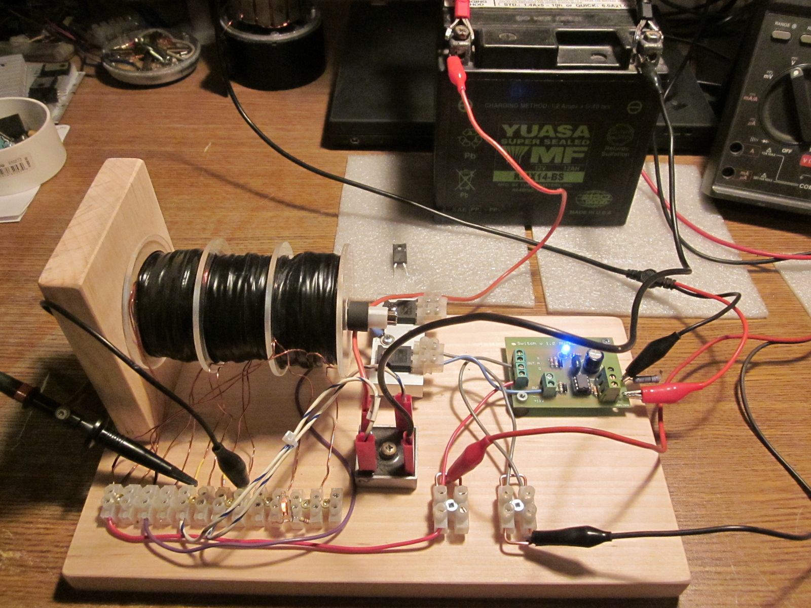

  • Hi all, here is the circuit i'm using and pic of coil and setup.
    • Just finished winding three coil setup so it can be tested further. All three coils are bifilar, AWG 21 and matched. Approx. 2.2Ω each strand (1.1Ω paralleled).
      Not everything is hooked up yet as I need to sit down and figure out the best way of running this.
      I' m using square pulse at 10% dc and 500V/20A Mosfets for switching. I can adjust both, dc and frequency but running at 100Hz a.t.m while watching charging rate with two different cores.
      I'm not running in 3 Batt configuration yet, just 12VDC.

          Yes, of course. I was just curious about something and wanted to compare two cores I have available in order to pick better one. I'm not done yet.

          • Hi all, been testing the 3 coil setup as shown in previous circuit drawing.
            It works well, i then decided to hook the output from secondary dc bridge, solely to the 3rd charge battery and also tried with a led bulb in series with the dc output from secondary bridge.
            This 3 coil setup does indeed behave different from the multi-filar coil.
            When testing the multi-filar coil, if i used 2 of the coils in series as a secondary to do the same thing, nothing could be pulled from the primary field collapse and vice versa.
            However, with this 3 coil design, i am now powering led bulbs in series with primary oscillator coil using flyback diode, into the 3rd charge battery and at the same time, i can power led bulbs in series off the dc output of the secondary coils bridge rectifier, then again into the 3rd charge battery.
            This 3 coil design does seem superior to multi-filar and anything else i have tried, for these purposes.

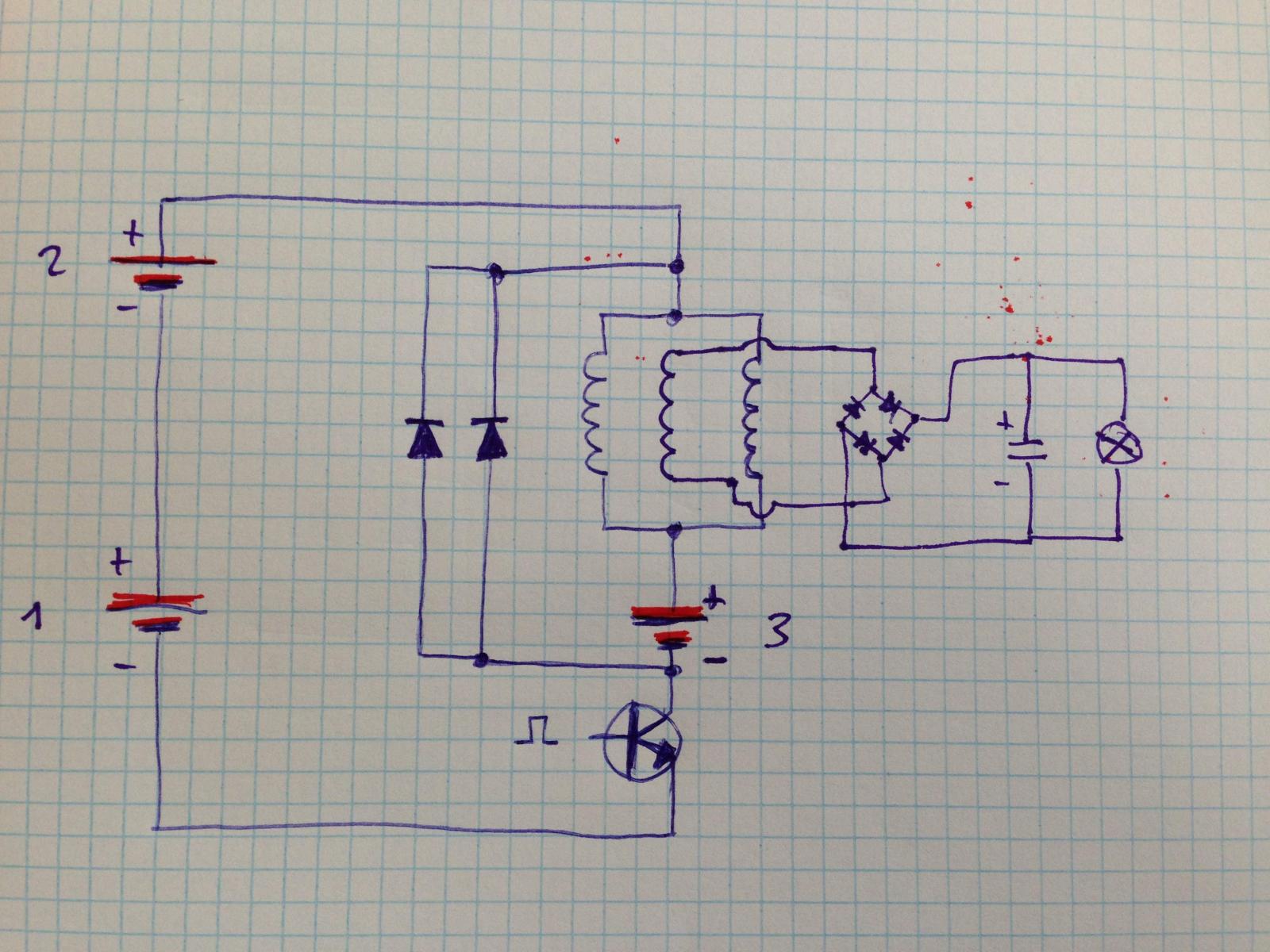

                        • This is a simplified schematic of how I'm running it. This way I don't have to use bifilars. I switch on the neg. side and the collapse of the primaries goes directly to batt 3. Nothing compared to your great schematics (I just don't find the time to do that..) but it gives an idea.
                          I'm using paralleled mosfets instead of the transistor.
                          Mario
                              Mario

                              Interesting idea. What is the freq. you're switching with? Did you try varying duty cycle?
                                Mario
                                Mario
                                Forgive me for my lack of electronic experience, i am trying to learn. On your schematic drawing,what is the symbol to the left of the transistor mean?
