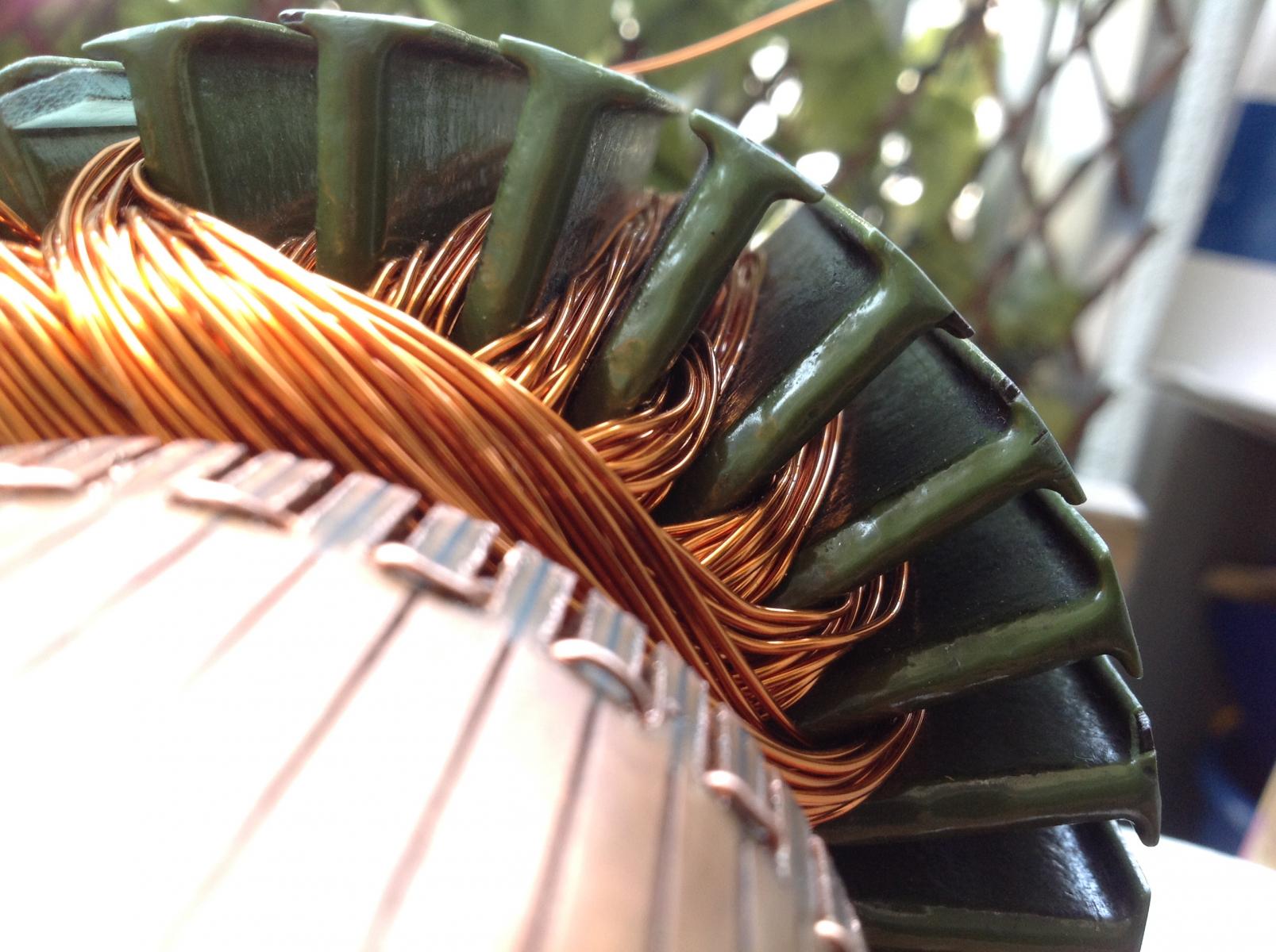

  • Midaztouch
    3hrs working on the A1MoGen
    More than halfway completed. I've used 36turns per singular coil. As you can see from the pic, there is plenty of room for extra turns. This is my 6th time to wind the Imperial P56. For me, I could probably wind 42 - 44 turns of 19.5 AWG. The hardest part is the wire build up between the commutator and the edge of the armature. The way the two commutators fit on the shaft is uneven. (Hey, we're using parts not designed for two comms.)
    Just for winding purposes, I would prefer to wind with 18.5 AWG or 19 AWG. Both gauges will get the job done but the thicker the wire, the easier winding for space/less turns.
    With a machine wind, I believe you can reach the proper amount of turns with the right tension on the wire.
    Keep it Clean and Green
    Midaz
