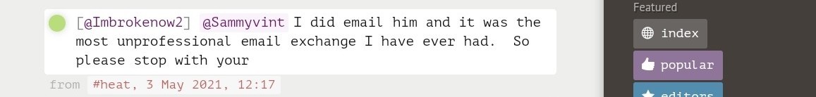

  • Oh Bro' Heins's stuff is delusional junk.
    This is a comment about Heins's email to potential investor. Screenshot_20210612-094908_Chrome~3.jpg

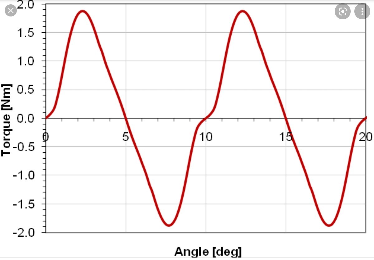

                • This little graph shows cogging torque. Sure you could use the negative torque but it's not for free, more positive torque is needed to make up the defecit. Screenshot_20210613-162512_Chrome~2.jpg This graph also shows cogging isn't costing.
                      Exactly, just like Bye said science teaches, cogging (Negative work) is free work AT SPEED. You guys stick with me and I'll get you on board.

                          You have always said cogging at speed is at no cost. How does it feel to be caught in your own mixed up mind. Don't worry, you are not the only one. You are the majority. You represent science as it is falsely taught. You spent years telling us cogging at speed comes free of charge.
                          Thane clearly shows that cogging and BEMF are NEGATIVE work done. Science teaches that negative work is done at no cost, just as you have said.
                            You conflate what I said. I said, at speed, cogging is not a loss mechanism, meaning it is give and take, gain and lose, the same amount each time the magnet approaches and departs the core for net zero energy. The moment of inertia, or angular momentum, of the rotor accounts for the intermittent energy storage and result is that cogging is typically unnoticeable.
                            "Science teaches that negative work is done at no cost, just as you have said" That is a lie. Actually two lies. I never said it and science never taught it. Just stop the lies and face the truth. And when you accuse someone of a lie on this board where there is a written record, supply the time stamped quote.
                            And "BEMF are[is] work" is also incorrect, negative or positive. Interesting that "Thane clearly shows" it. How does he account for units discrepancy or does he believe volts and joules are the same thing?
