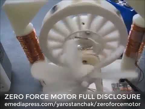

                          • Some things to consider on this version...
                            Output from 12 coils was around 1800 watts
                            This machine has 10 coils instead of 12 so that should drop the output to around 1500 watts
                            BUT it has 22 magnets instead of 12 magnets on the rotor, so that should increase the output above 1500 watts. By how much, I have no idea.
                            The old machine had to run at 2800 RPM to achieve speed up under load. With 22 magnets, that required speed may be significantly reduced. So it may be speeding up under load when I don't WANT it to. The output of the coil goes DOWN when the coil is causing speed up under load. You get MAX coil output when the coil is neutral... neither slowing the motor nor speeding it up. There are two ways of addressing this. One is to simply reduce the RPM of the rotor. This will lower the input, but it will also lower the output, which we don't want. The OTHER way to address it is to reduce the capacitance of the coil by changing the way the wires are connected. Fewer wires in series means more wires in parallel, so the voltage output goes down but the amperage goes up. I'm not sure how the reduced capacitance of the coil will affect the output of the coil. Time will tell. I will have to figure all these things out before the final run of this machine to be recorded. Otherwise the potential of it will not be realized. So if anyone was hoping I would just slap it together and film a video, that isn't going to happen. There is still work to be done. But I will be sending videos to Aaron so he can see what the progress is.
                            There are many things that need to be worked out on this machine, which is why I brought it here hoping others would replicate and they could be worked out as a group. But thanks to people like bi, that has not happened. Here are a few of them:
                            What sized magnets should be used on the rotor? I'm sure every core material has limits to how much flux it will accept, so the magnets I am using may be overkill, or they may need to be twice as big for the size core I have in my coils to MAX out that core and max out the coil output. Will larger diameter coils on the same size cores output tons more energy? In other words, would two or three times as much wire on the coil increase the output by two or three times for no greater cost on the input. I don't know the answers to these questions, because that is ongoing research that I never got around to. It would require custom coil bobbins that hold much more wire, a bigger rotor and thus more magnets and a much bigger machine.
                            So... Materials and parts for generator were $314.00. Good luck finding those materials at anywhere near that price though. That's everything on my bench in the video, plus the rotor, which was not sitting on my bench. That doesn't account for the cost of all the machine work to actually MAKE those parts. Oh, and my friend threw in the frame that holds the whole thing for free and a friend of HIS did the powder coating on the metal for free.
                            Magnets were $305 plus shipping from Applied Magnets.
                            Wire is $685.00 for Five 11 pound spools of #23 ( The spool length is 6,893.7 feet ) https://www.magnet4sale.com/magnet-w...s-11-lb-spool/
                            That's a total cost of $1,304.00 not including shipping for all of that stuff or machine work to turn the plastic and steel into what it is today. And this is not the 1st version of this generator I have shown. I'm pretty sure if you go back through all the pictures I have posted over the years you will find at least 12 versions of this machine that I bothered to POST about, not to mention that there were sometimes two or three of one version that I built correcting for small problems before giving up and moving on to a newer, better version. I think this version solves every problem I have run across, but we will see once it is up and running.
                            So I have a few dollars invested in this project over the years. Because I believe it is worth it. I didn't con anyone into giving me money to do this. I didn't sell anything to raise the money for these builds. I have given lots of stuff away for the cost of shipping. In fact, I have a machine pretty much like this one that is sitting on the shelf in my garage that I would gladly send to anyone who is interested. For the cost of shipping in advance. I have been burned too many times by people promising me they would pay for stuff and then I get nothing. It is just the four pieces used to hold the coils. I have a rotor that goes with it, but the magnets stick out of that rotor, so I am scared to run it after I saw what happens when those magnets hit something. I would include the rotor so you can remove the magnets and put them in a NEW rotor, but you would have to have that rotor made. The base plate was lost during the move to the new house, and I simply cannot find it. I have no idea how that could have even happened, but it did.
                              More magnet poles hitting a coil increased the freq. Wiring more coils in series allows for speed up at a lower RPM and will sacrifice output. My 10 pole gives 265hz @ 1600rpm and a 12 pole is 320hz @1600rpm. Raising the freq of magnets passing a coil by better than 57% would give a higher value in Hz increase of 182hz @ 2800 rpm or better so figure 400hz. This is the aviation and military standard. Smart designer. Perfect. With such an output you can run a 400hz lighting system to match your generator where otherwise the operator would be stuck fishing for endless loading devices. At 400hz vs 60Hz systems there is either a 5 to 1 reduction weight ratio or a 5 to 1 power increase for equal size (physical) units.
                              More magnets use more power to propel across the coil cores that normally would produce more drag than a slower less populated rotor. Hopefully magnetically cancelled rotors will reduce this enormous increase. If this is done COP will skyrocket.
                              The best way to measure power outputs of freq that keeps changing is to rectify to dc where hz disappear, store the energy in a set of caps found on the frame of a converter known as a VFD. This way you can convert the dc power to any freq you like at a 95% conversion efficiency. Also you can run standard 60hz devices that can not run on 400hz. Running a number of 60hz light bulbs on 300hz-450hz will shorten their life and give a poor energy utilization efficiency. Power wasting.
                              Standard 400hz to 60hz VFD's have been coming down in price for 20 years. This is an excellent way to keep the size of the generator small and still get a 5X energy output. Recommendation. BUY IT. You will never get a better obsolete setup.
