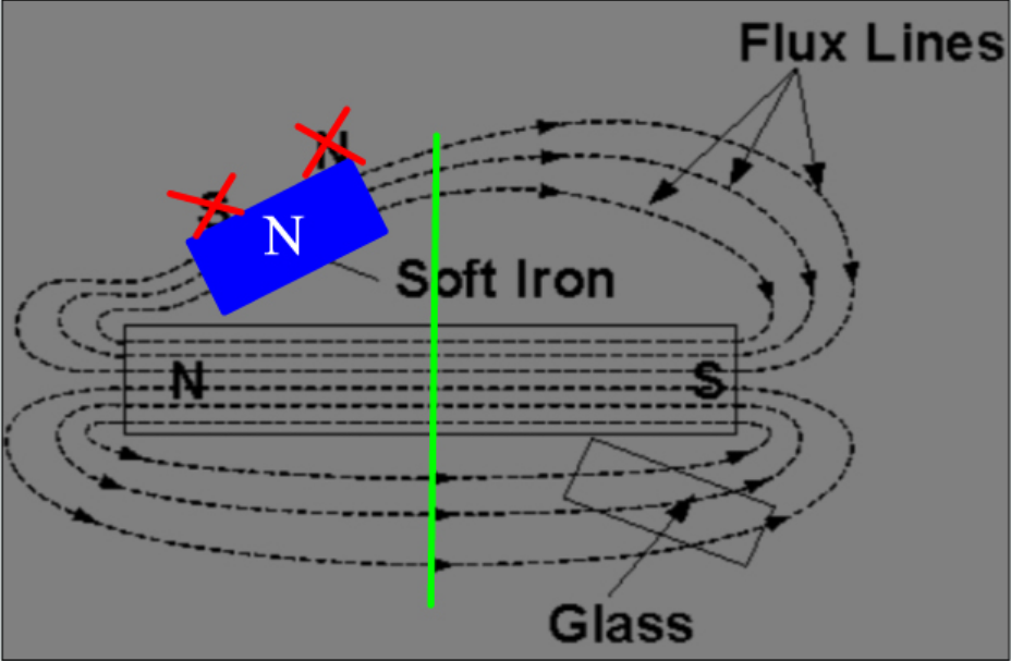

You mean this picture?
The magnets (S of one shown & N of the other) are not independent. The same flux passes through both of them. They are simply "cut off" in the illustration for clarity; obviously there cannot be an independent S magnet on one side of the gap and a different independent N on the opposite. But that illustration does in fact show the magnetic field as uniform; for simplicity. In the real world, the field would not be uniform. It would fringe at the edges of the poles and, depending on the rest of the magnetic circuit (not shown), may even be weaker near the center of the poles.
You can see in that picture 3 force vectors. Each force vector would need to be calculated using the B vector and v vector for the charge q at that particular location and time. The force at that instant acting on q along with all the other forces acting on q at that instant will determine the acceleration according to the mass of the charge and ultimately determine the trajectory. That is why it is shown as a curve instead of a sharp upwards turn.
