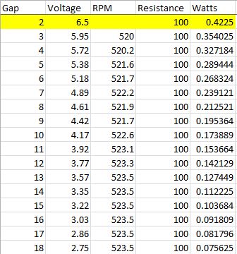

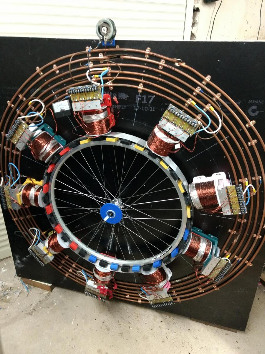

          I have been testing some 8 filar 23awg bobbins with iron cores.
          Using some very basic methods and a prime mover I achieved the following results. Running 4 of these coils in parallel I can peak the BUS at 120VDC.
          Ive been running 120 Led's while losing 20RPM but also using less current on the prime mover with a better secondary recharge rate.
          I have been adjusting and tinkering with these coils and currently peaking at .6w per coil.
