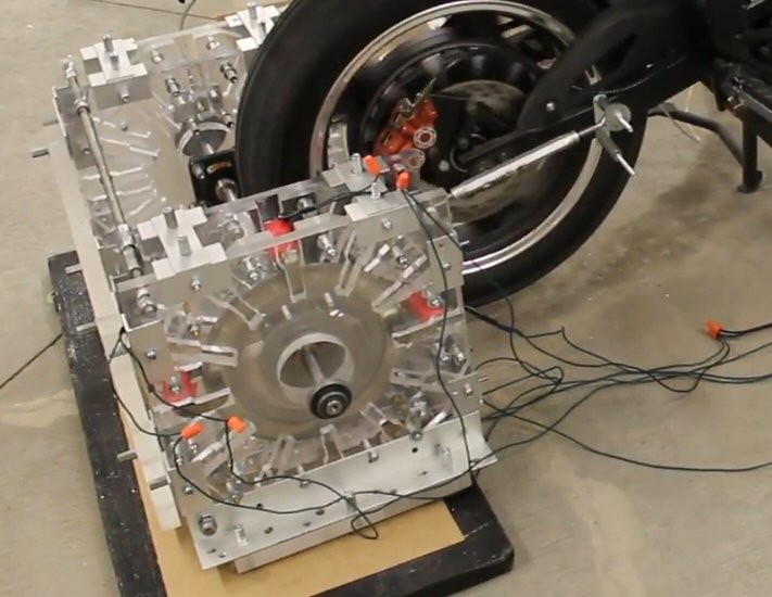

  • 3 C core coils using a 24 pole magnet rotor (or 20 pole) gives unlimited range. The Ebike takes 5 amps at 75vdc to run and the ReGenX generator puts 5.3amps back into the battery.
      Another display of stupidity. From obvious meter readings, battery current does not change signs (- to +) at switching to and from "Regen acceleration" and during test, battery voltage is always below battery open circuit voltage (77Vdc, shown on meter after test shutdown at end of video).
        If you listened at one point he says the voltage is also 74vdc which was during normal operation or conventional discharging. So I am not sure why that is a problem. If you have a technical question that I can understand I will do my best to answer it. What is the question?
        Let's lay out the machine first. Ebike has motor running at 5 amps and 75vdc approx (without splitting hairs) then lexan boxes in the back end capable of holding 24 coils using both side only has 3 coils send energy back to the batteries. I hope this clears things up. Other consideration for conversion are not discussed as this is standard practice for those who are skilled in the art. "Skilled in the art" someone who half-azzed knows what he is looking at.

        • It is such a simple idea. The ebike motor out of the factory delivers 5 amps at 75vdc (approx)
          The ReGenX rotor (Approx 14" dia) with 1" magnets (approx 20) at 1/2" thick pressed into holder sleeves which are press fit/ epoxied. Probably sleeves are spot welded to rotor then mic-ed- then pressed . Next is 3 C Core coils that gently assist the back wheel which in turn slightly eases battery consumption while delivering 5.34 amps back to the battery at the said voltage. Unlimited range is so simple.
          If you see what I see then you would know.
            Do you know how to use a battery? How to discharge a battery? How to charge a battery?
            How can you charge a battery with a current through the battery which is in the same direction as when it was discharged?
            How can you charge a battery when its terminal voltage is lower than its open circuit voltage?

              I don't have time to skill you in the art so to short form the answer look at an automobile and the way it draws power from the battery and the alternator charges the battery at the same time. Feel free to ask any question but remember that you or I do not know everything. If you stay open something new can enter your thought process.
              Also note that on the Ebike there is a charge controller. It is located where the gas tank normally is but this is an electric bike. The ReGenX coils probably produce anywhere from 100vac-300vac depending on RPM with each coil producing around 2 amps max in this setting. In previous video's the coils actually have a substantially high max amp rating. 5 amp max but heating up.
              Many charge controller are available in electric car systems. As a simplified for instance coils must be designed to produce 20-30vac in a car alternator depending on the RPM of the car's gas engine in order to regulate down to 13.8vdc after including rectification. These systems are not as simple as Thane may make them look. Always remember that Thane is an engineering genius, way out in front of the pack.

                Thane is an idiot. If he was right in what he claims and says at the end of that video that the electric scooter can run forever without charging, why doesn't he prove it by just not turning it off. Just leave it run, and run, and run. For hours, days, weeks, and more. He can't because it doesn't remotely function as he claims. He is full of BS.
                You can't charge and discharge a battery simultaneously. And you can't charge a battery at lower potential than it is at open circuit.

                  • Actually you can not charge and discharge the battery simultaneously. When you start the car the alternator charges the battery while all other loads are drawing power from the alternator, the battery at this point is simply another load in the overall circuit. You can remove the battery because your powering the alternator with and external source of energy. If the charging ( or alternator output ) is lower than the load requirements then the output is shared between the battery and alternator output. For instance a 200 watt load with a 100 watt output of the alternator - the alternator would supply 100 watts and a watt meter would show a 100 watt drain on the battery. If the output of the alternator was 200 watts and you had a 100 watt load then the battery would be charged with 100 watts while the load dissipated 100 watts. There really isn't any "magic" going on there nor in Thanes machines...
