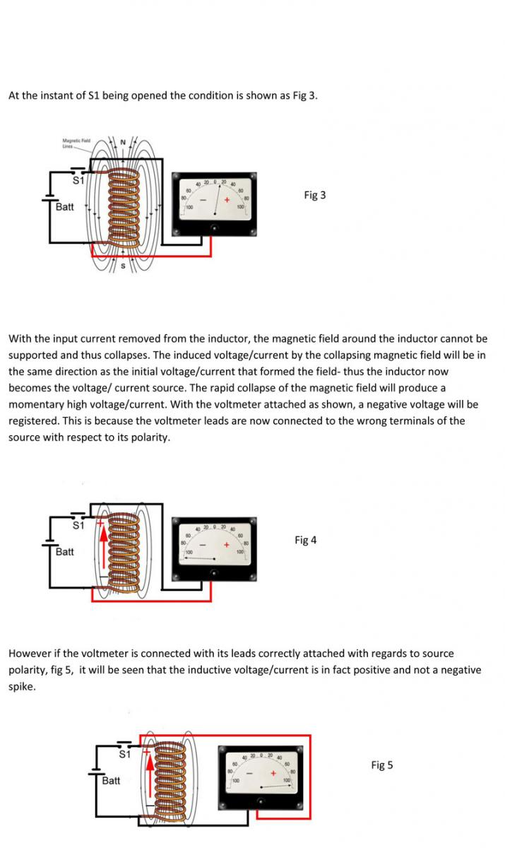

        Well Allen, I was just trying to help with a lesson on inductance which you did not appear to understand. You kept after me for more explanations of other people's experiments concerning a subject I have not been following nor have any interest in analyzing. No good deed goes unpunished, as they say.
        • #19

          Hi All
          Re the direction reversal, I wrote the attached a few years back, that may be of help. It depends upon the position of the voltmeter.
          Kind regards
          John

            Voltmeter position.
            @John g,
            Thank you very much. That last post was extremely helpful for me.
