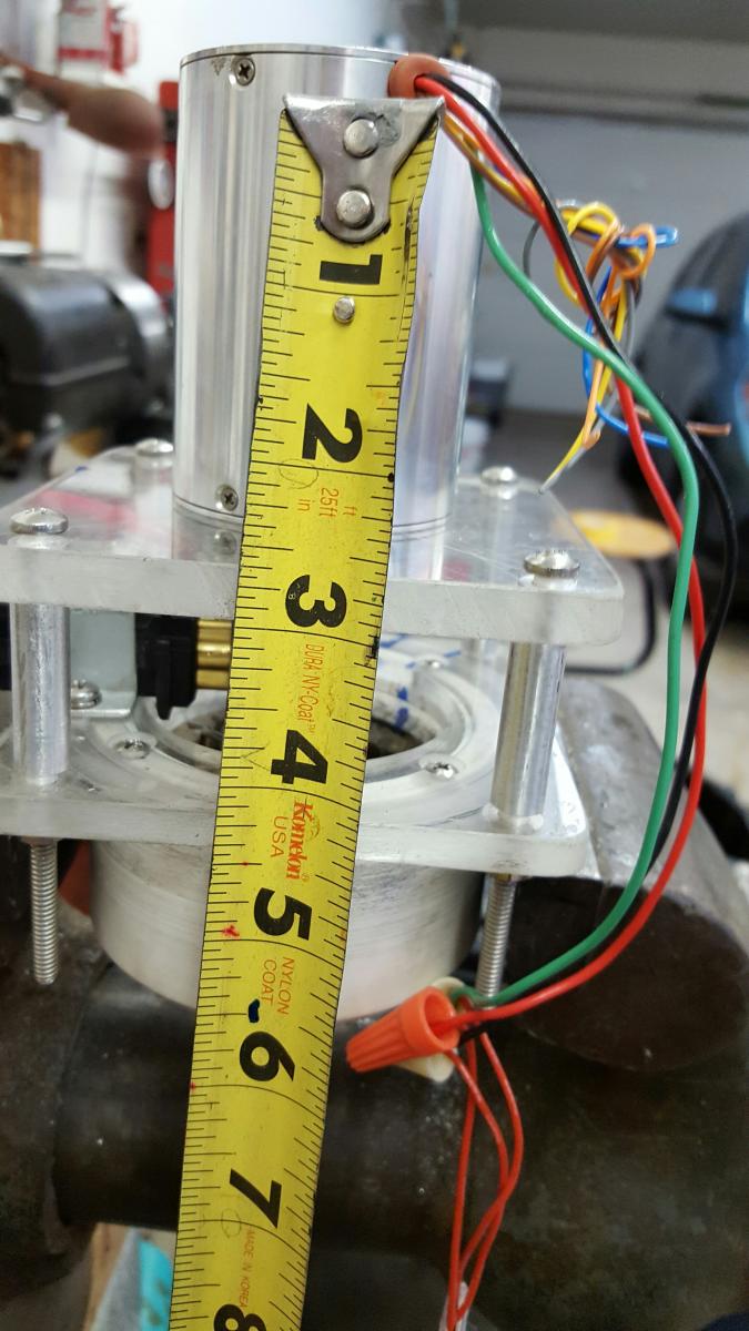

@ Cornboy: Hello Cornboy, I meant to write the day when your test failed...but I couldn't...so, I will do now:
Your brush distance from shaft/aluminum drum to contact surface is too long, this causes a lot of play and vibrations when running, got to be much closer, more compact.
I was gonna ask you...did you try opening Part G windings and just leaving some copper rings not connected for brush to ride on...when making the bulbs test?

@ UFO, no i havn't split the winding yet.
It's not worth testing until i sort out the rotary internal brush properly, it has to be very accurate and very solid and stable, for best results.
I will also be using a heavier brush from a traction motor, which if need be can span at least 4 bars.
My only and main concern is enough magnetic resistance in the toroid, and primaries, as a whole circuit, to limit the start up current down to manageable levels.
I won't be testing the whole power circuit, until i have a load on the output secondary, and have the second secondary rectified an fed back to input of brush.
Once the input is fed from the s.secondary, and outside source dis connected, i am thinking that high current won't be an issue internally in the device.
I will also be using a heavier brush from a traction motor, which if need be can span at least 4 bars.`-QUOTE+
Will be very interesting.
Regards Cornboy.
According to your Part G config...you will need quite some amps and not much voltage to generate the right flow, then generating a field.
I highly recommend that you get it first running at a suitable speed...like 1800 RPM's (50%) or so, before even applying one single amp. Then increasing amperage-voltage very, very slowly regulated...
