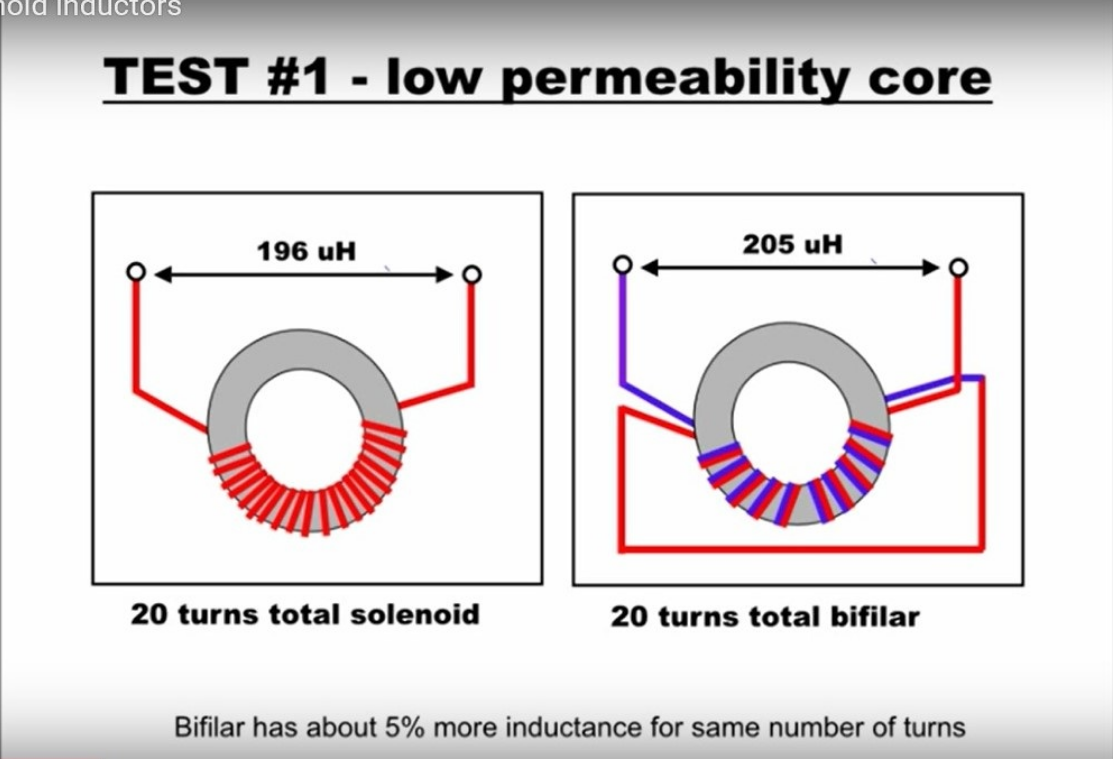

                    • Bifilar and single wire inductance.
                      I used Xee2's inductance measures that show a 5% greater Micro-Henries of inductance in his series biflar then his single wound coil of equal turns and wire gauge on both a low and high perm ferrite toroid core.
                      I reviewed my inductance measurements of two air core bifilar and single wire coils and measured a 10% higher inductance in the series bifilar. The problem was I ran out of space on the bobbin for the single wire at 4 Ohms, while the bifilar measured 5 Ohms. I divided the Ohms into the Milli-Henries for a ratio and arrived at a 10% greater inductance for the bifilar, twice the percentage of Xee2.
                      I think the extra difference may be a consequence of my "Home style wrap" so I plan to do one more test with two tight coils of equal turns on a High-Perm ferrite core.

                          • Allen's math
                            @ramset,
                            I have two projects on my test bench right now; Let me start with the math:
                            Xee2 has a series bifilar and a single wire coil of equal turns on two identical high perm cores.
                            The single wire coil measures 15.9 Milli-Henrys and the bifilar 16.8 Milli-Henrys of inductance.
                            We know that it takes 3600 Joules per second to generate 1 Tesla of magnetic force in a coil of 1 Henry of inductance, and that 1 Tesla is equal to 10,000 Gauss; Therefore:
                            16.8 mH divided by 10,000 equals 168 Gauss for the bifilar and 159 Gauss for the single wire at the following power input:
                            10,000 divided by 3600 equals 2.777. Multiplied by 168 Gauss equals 466.6 Joules per second or 466.6 Watts.
                            Multiplying the single wire Gauss by the same factor equals 441.5 watts.
                            Deducting the the 441.5 from the 466.6 gives us 25.1 watts.
                            So, the gain factor for the bifilar over the single wire coil with the high perm ferrite core is 25.1 watts. That's the power we would save to generate a magnetic field of identical force with the series bifilar wrap over the single wire coil of equal windings.
                            First, here is the source for the 2 Xee2 coils Allen mentions. I did google search briefly but could not find the true source. http://www.energeticforum.com/301121-post178.html
                            So we don't know a lot about the coils like size, resistance, etc.
                            Next let's look at Allen's first calculation:
                            16.8 mH / 10000 = 0.00168 mH = 1.68 uH. But Allen's answer to this mathematical operation is 168 gauss. So I guess Allen meant multiply instead of divide. 16.8 mH * 10000 = 168 gauss.
                            This does coincide with what Allen claims "we" all know (I don't know who else he thinks knows this falsehood, but we'll carry on with it), that a henry = tesla. So if we convert 16.8 mH to H, we have 0.0168H. Which according to Allen is equal to 0.0168T. A unit tesla is equal to 10000 gauss units. So 0.0168T = 168G.
                            Proceeding to Allen's next calculation:
                            This calculation comes from his claim that:
                            It takes 3600 Joules per second to generate 1 Tesla or 10,000 Gauss in a coil of 1 Henry.
                            And looking at the line:
                            you can see it is a simple factor of 2.777 watts per gauss, or 2.777W/G, or 3600 J/(T*s).
                            What does this imply? That coil lying on the bench has an inductance of 16.8mH. Then it has a magnetic flux density of 16.8mT (or 168G) always. No matter what. And it always has 441.5W. It always uses and or converts 441.5 watts of power no matter what.
                            That is an incredible claim.

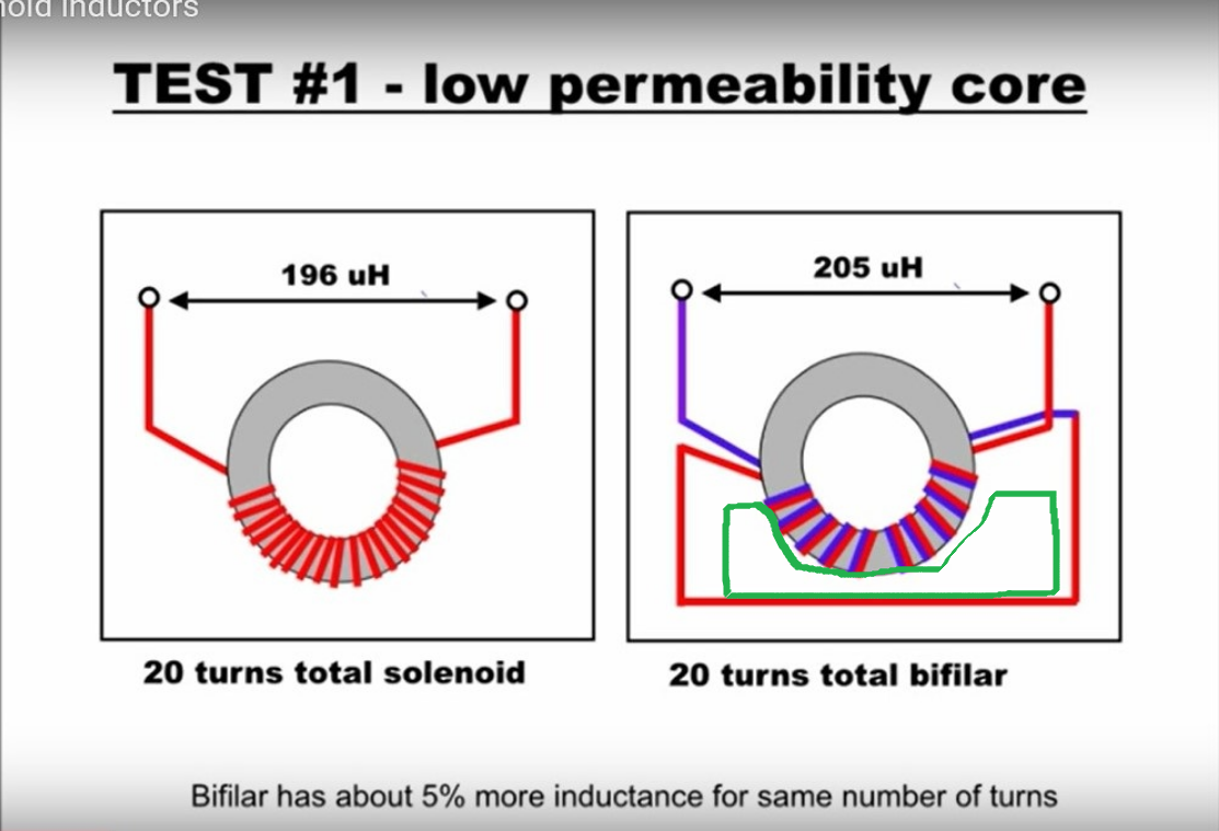

                            • Extra turn
                              Xee2 tested the inductance of the two different kinds of windings on ferrite cores and measured a 5% increase in the series bifilar in both low and high perm cores:
                              I want to point out a peculiar fact often overlooked concerning toroid wound inductors and bifilar series connected winding. The two coils in the attachment were measured for inductance and the bifilar showed 5% higher. They each had 20 turns around the core. This neglects the "extra" turn (or loop) in series with the 20 turns on the bifilar. See the green path. So a cursory look is 21 turns versus 20 turns or a 5% increase in loops and associated wire length. It is likely a complicated calculation to determine the exact contribution to inductance from this extra turn due to the fact that it is not on the same core as the other turns and its flux linkage and mutual coupling are unknown. But it is obvious to me it will contribute.

                                The series bifilar coil with it resonant voltage rise is indeed a completely different animal.
