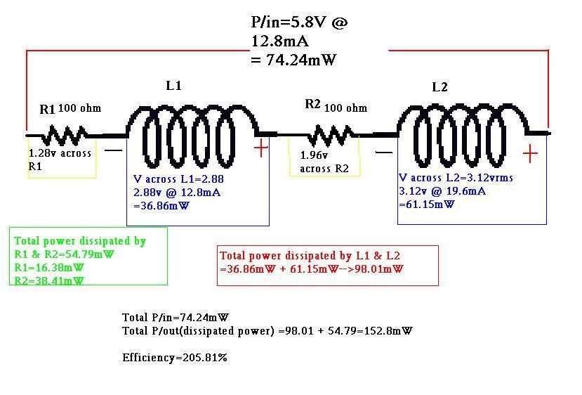

      • Tinmans video
        https://www.youtube.com/watch?v=RnndKlAsq4E
        @Tinman,
        The gain is stored in the magnetic field and is measured in "Negative Henries". This measurement has an electrical power equivalent!

          • AC/DC ---Who cares?
            "This measurement" which Allen refers to is crap because it is obviously AC from the video and treated as though it is DC, ignoring the phase shift of current to voltage (pf). The experimenter needs to use impedances with complex arithmetic for the circuit and power calculations.
            http://www.energeticforum.com/attach...ns-circuit-png

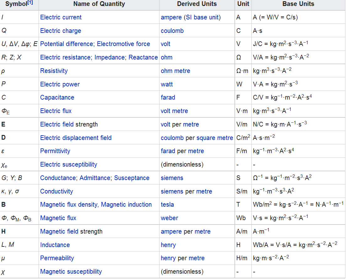

                  • Units
                    Here is an easy reference for SI units from https://en.wikipedia.org/wiki/Intern...ystem_of_Units
                    You can find may more by like using Google search for SI units.
                    And Allen, what is the question about textbooks? In case you don't know, they are found at libraries and schools.
                        @bistander,
                        Quote from bistander:
                        "The experimenter needs to use impedances with complex arithmetic for the circuit and power calculations".
                        We need bystander to confuse us with calculations that are too hard for him to deal with.
                        Look how simple this really is:
                        "Definitions. In both AC and DC fields, the reluctance is the ratio of the "magnetomotive force” (MMF) in a magnetic circuit to the magnetic flux in this circuit".
