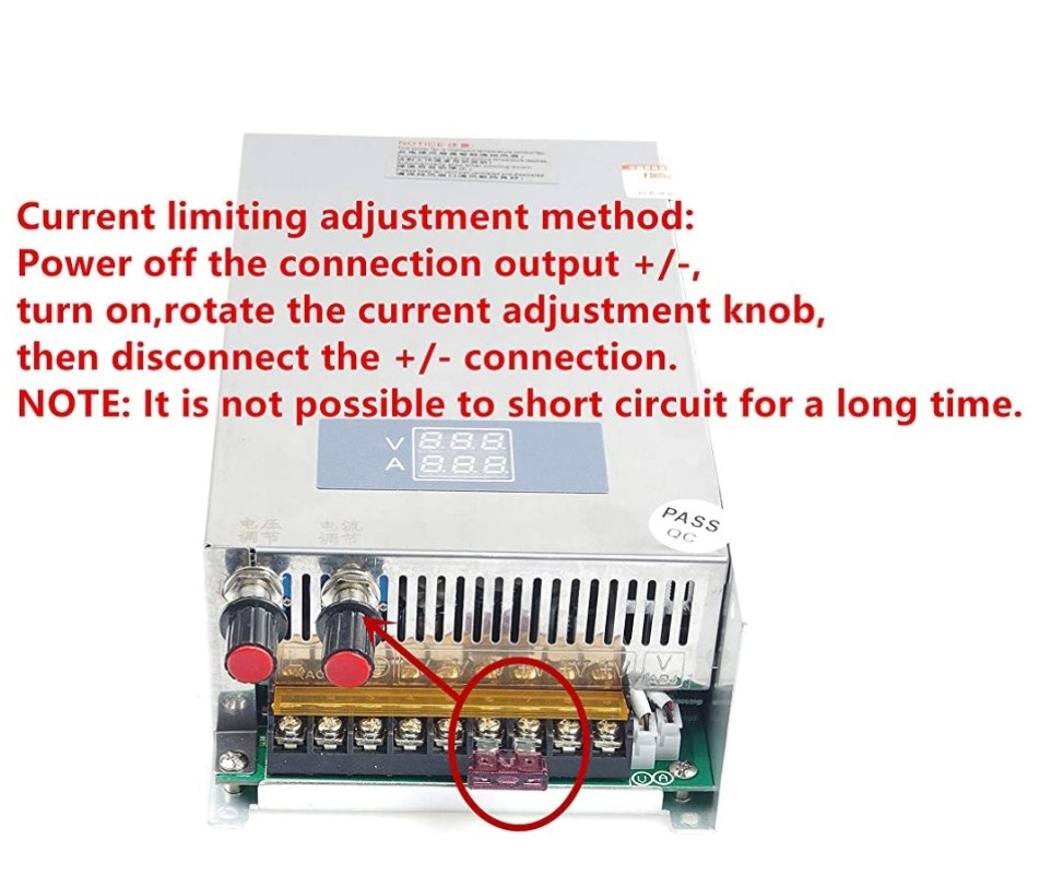

    With that Amazon power supply you can set the current limit. That should control acceleration rate and keep it from overloading.
    https://www.amazon.com/LIVISN-Adjust...cs&sr=1-4&th=1
    Edit2: note Amazon no longer shows the 36V, 28A model. Must have sold out.

    I heard from Greyland late last night. The 20 amp power supply he is using for testing has burnt out because the DC motor draws more than 20 amps on startup even though it settles down to around half that when up to speed. I’m not sure I have a solution to that problem. They are purchasing a NEW power supply today on Amazon:
    This won’t solve the problem. Maybe TWO of them in parallel connected by diodes? I’m not sure what to do. I haven’t been able to find a DC supply that outputs more amps than this and also the correct voltage. I like this one because it shows output in volts and amps and resolves ONE of the questions bi has about the machine. Any ideas?
    Hi Turion,
    Previously you said the DC power supply allowed you to control RPM therefore it should have allowed you to bring up the voltage slowly enough to maintain current level and avoid overload. It would take longer to reach desired speed. But too late for that.
    ​​​​​​For the price of that linked power supply, you could get 3 decent 12 volt batteries. Use voltmeter and ammeter. And DC motor speed control.
    You'll be limited by the AC outlet for power supplies unless you go up to a 240VAC model. And higher power variable supplies are expensive. I have a nice collection amassed over the years from eBay. Some great deals, but I've also been burned.
    The induction motor (with Kill-a-watt meter) seemed like a solution to me. It was able to accelerate the generator up to speed without tripping the breaker.
