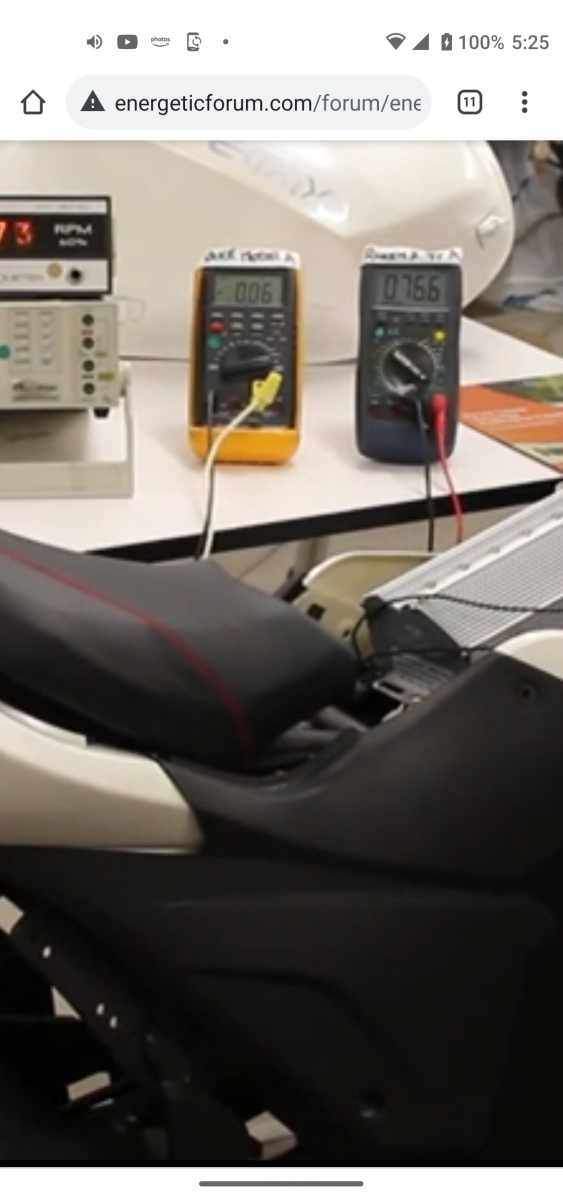

    Good observation bistander, that 76.6v gave the game away!

    You are becoming mixed up and multiple video's and the data. I am not surprised. You always do this. The video I recently posted shows the ebike parts all moving and the battery voltages reverses it's decline upon throwing the switch. At this point work in being done and the battery is on it's way to over charging in a short time.
    There is also a bench top unit with 3 painted or colored coils doing the same thing.

    It is simple, Thane's ebike parts like the wheel and the bearing drag takes energy and then Thane shows us the ebike motor battery power is as follows. 74.5vdc at 5amp draw and dropping.
    Then Thane is showing the heavy parts of the ebike moving, throws the switch.
    When the switch is throw the battery voltages starts climbing because the generator coils are delivering 75+vdc at 5.5amps while work is being done. So all of that work is taking place and the battery voltage goes up.
    Are you that blind, that you can't see how the mass represents the seat of your pants needing a ride? Something has to move down the road.
    Thane doesn't know what he's talking about. One can easily see the ammeter and voltmeter. The ammeter always shows a negative sign when at the 5 to 6 amp readings. And even more telling is the voltmeter reading just after he shuts down the bike and current drops to zero, or .06. See the screenshot from the video I post here.
    It reads 76.6 volts. That is the open circuit battery voltage. The battery is not charging unless its terminal voltage is above 76.6V. That is fact. The ammeter would also change sign with charge current. It never does. All the while the motor is running, the battery voltage is below 76.6V. The system is always running from and draining the battery, no matter what he or others say. Open your eyes. Think for yourself. Thane has nothing of value.
    In this example the ebike generator unit is running 74.5v and 5amps then the coils are connected showing in real time the ebike doing the same work and the battery is now getting 75v and over 5amps forcing the battery up. In other words a free lunch.
    Edit:
    You cannot charge a battery using a voltage lower than its open circuit voltage, sometimes called resting voltage, which he shows towards the end after he shuts down the bike at 76.6V. He can't be charging that battery at 75V. Fact.
