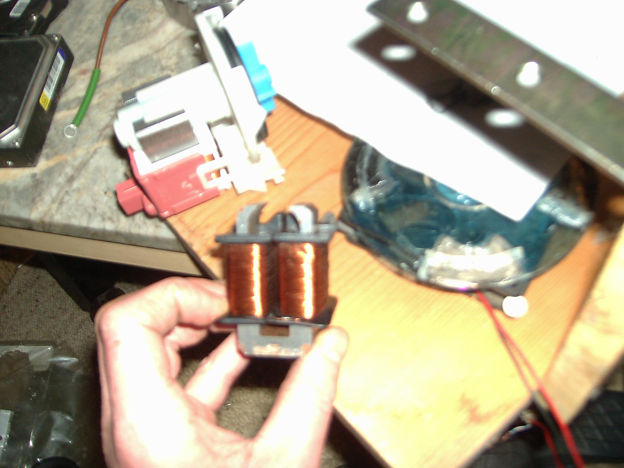

    Hi,
    I look right now about the 'Perfect Coil'.
    Now, i take the Motor from a Washing machine, take the Core and the Coil from it,
    and i got more then 10x V from it, when i attach it to my Fan and Magnets, as if i hold it in normally Way close.
    This Core has a U-Form, and isnt optimized in any Way, like the sheetiron is isolated.
    Number (red)1 and 2 at Picture 2 are the Magnets, they are from an Harddrive, and have some Weird Flux.
    It looks like, they are made from 2 Pieces, build into one.
    Red 3 is the Direction of the Sheetiron, and the Coild are 90° turned.
    When i attach the Core with the U facing upwards, i got about .2 V,
    but at the other Driection about 12V.
    But it works even from Side too, as the last Pic show, even some better.
    I run the Fan at 6V Dc, but still got no Amps from it, or very less.
    But the Coilsetup is worth a Try.

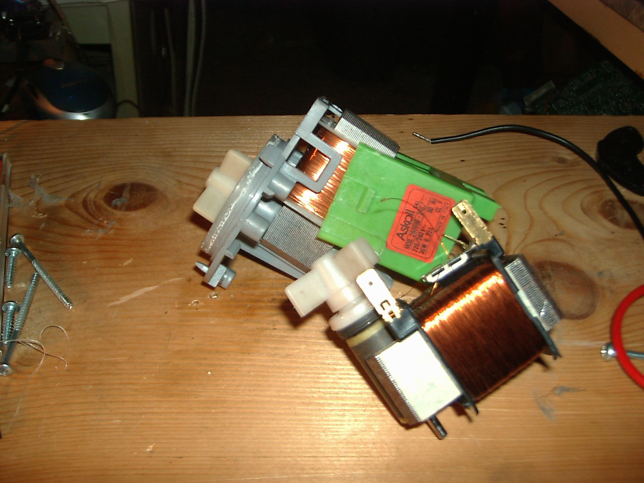

      Hi Gmeat,
      It was a Privileg machine, its the Brand of a Catalog Company here in Germany,
      but i found the same Motor into a newer Miele or AEG Dishwascher.
      The Manufactor is Askoll from Italy, and i found it at the Junkyard.
      There been couple of this Machines.
      The Coil is allready at the Motor, i only removed the Case and the Magnet from it.
      Then i got the Core and the Coil from it.
      The wire is 0,2mm ( 0.001in) and both Coils have 180ohm resistance.
      The Motor runs usual at 220Ac/30Watts.

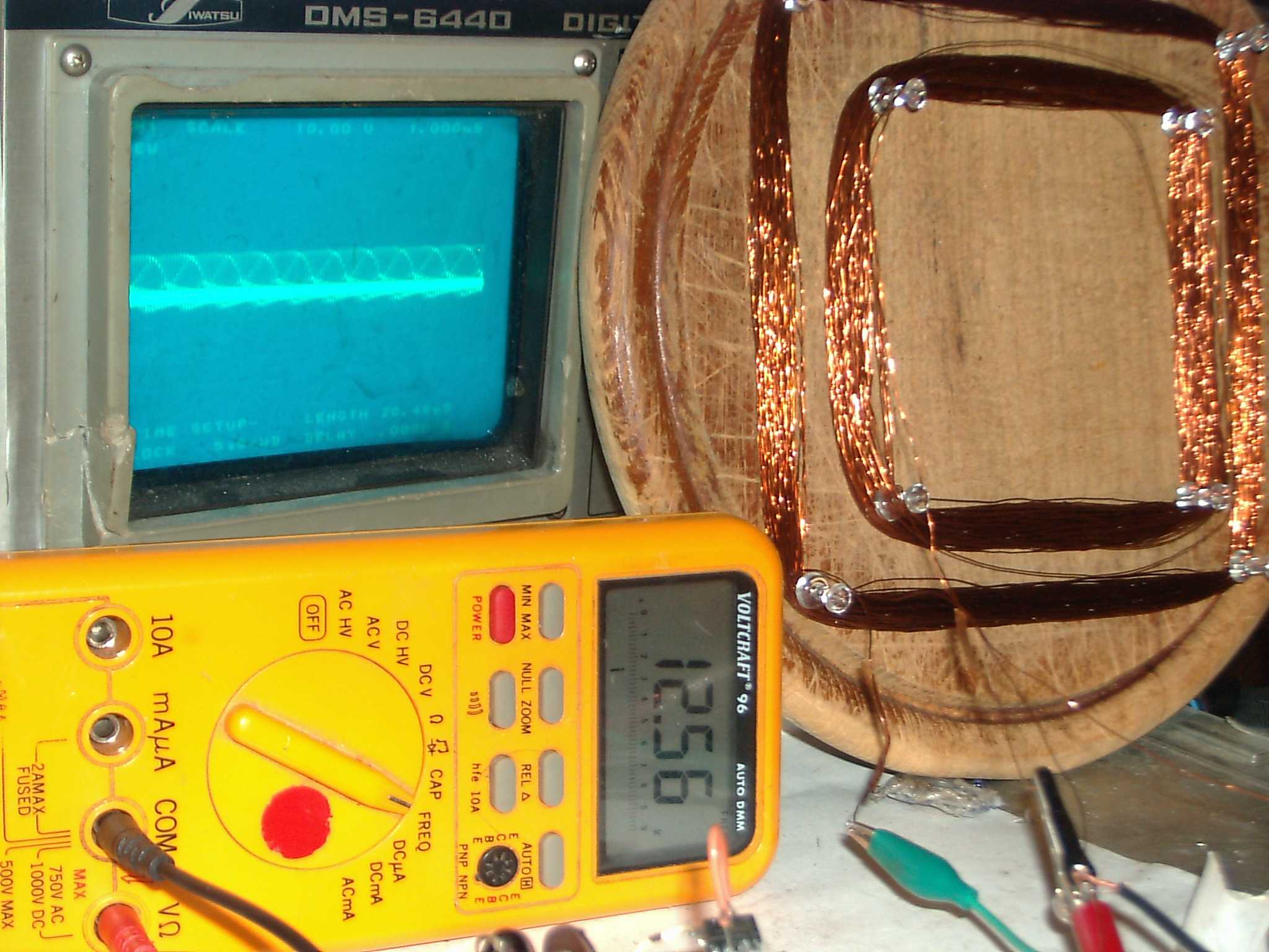

                Hi,
                It is the number of turns that constitutes the induced voltage amplitude, besides the the rate and amount of flux change. So to get high induced voltage you invariably would use high number of turns but in case of thin wire you introduce more resistance as well. So you would use thick wire to reduce the resistance but thick wire needs bigger winding area for the same or comparable induced voltage amplitude and now your winding area on that plastic spool is a given size. So you have to make do with less induced voltage for the thick wire case if using the same spool.
                Say you got 12V induced voltage from your 120 Ohm coil. Say you load it with a 20 Ohm resistor. The current in your coil and in the 20 Ohm will be 12V/(120+20)= 0.085A or so. Now this current makes a differing voltage drop in the coil and across the 20 Ohm load. Inside the coil the voltage drop is Vc=0.085*120=10.2V and across the load the voltage drop is Vl=0.085*20=1.7V This is a big loss for the coil (10.2V times 0.085A is dissipated in the coil wire), just due to its rather high inner resistance.
                If you could make a coil with thick wire that gives say 4 Ohm inner resistance only but say you could induce still a good 6V in it (with a less number of turns), then the current in the same 20 Ohm load would be 0.25A (6V/(4+20)=0.25A) and most of the heat would be created in the 20 Ohm now, a much better situation, compared to the previous case.
                (I simplified the digits above a little.)
                rgds, Gyula
                  Hi again,
                  Thanks for Explaining me this, very usefull.
                  But no good news from me, i tried to make it with 0,9 Wire, and got now 0.4 Amps, but only 0,6 Voltage. I guess, the wire was a little to big.
                  The other Coils, i had there did have both about 90 Ohms, when i split them.
                  But i see what you mean, it shows the effect very well.

                        And well, i found this benched Magnets inside a Blower Fan at the Frontside
                        from a Car, what Howard Jones seems use at his Motor. They are about 4cm(1,46inch) wide, and 5cm( 1,98inch) long and benched.
                        Just once is the Northpole outside, and once inside at one Pair of them.
                        Maybe you should put 3 beside, and slightly diagonal shifted, when someone try to build a Motor with it.

                            Ok Time is passing by, Coils change, and i made another Coil with a small Coil at the middle.
                            I like the Way to build it, anyhow simple to do, and much to play around with it.
                            Video
                            Left Picture is again the big Coil with the small one over, just some sharper (i hope) as at the Video,
                            this Quad Coil at Wood is a Experiment from Ou.de,
                            where someone want to spread this Setup, after his Theorie, it should give OU.
                            We want to figure it out and work on it, and he looks for rebuilder,
                            before the 'Copycats' wanna put her Claws on it.
                            Right now, i dont know, if he only has a Theorie, or some practical backround.
                            its the same as with my Coil, it gives Voltage, but with the Quad setup no Ah (2mA),
                            my guessing, the distance is to big for it.
