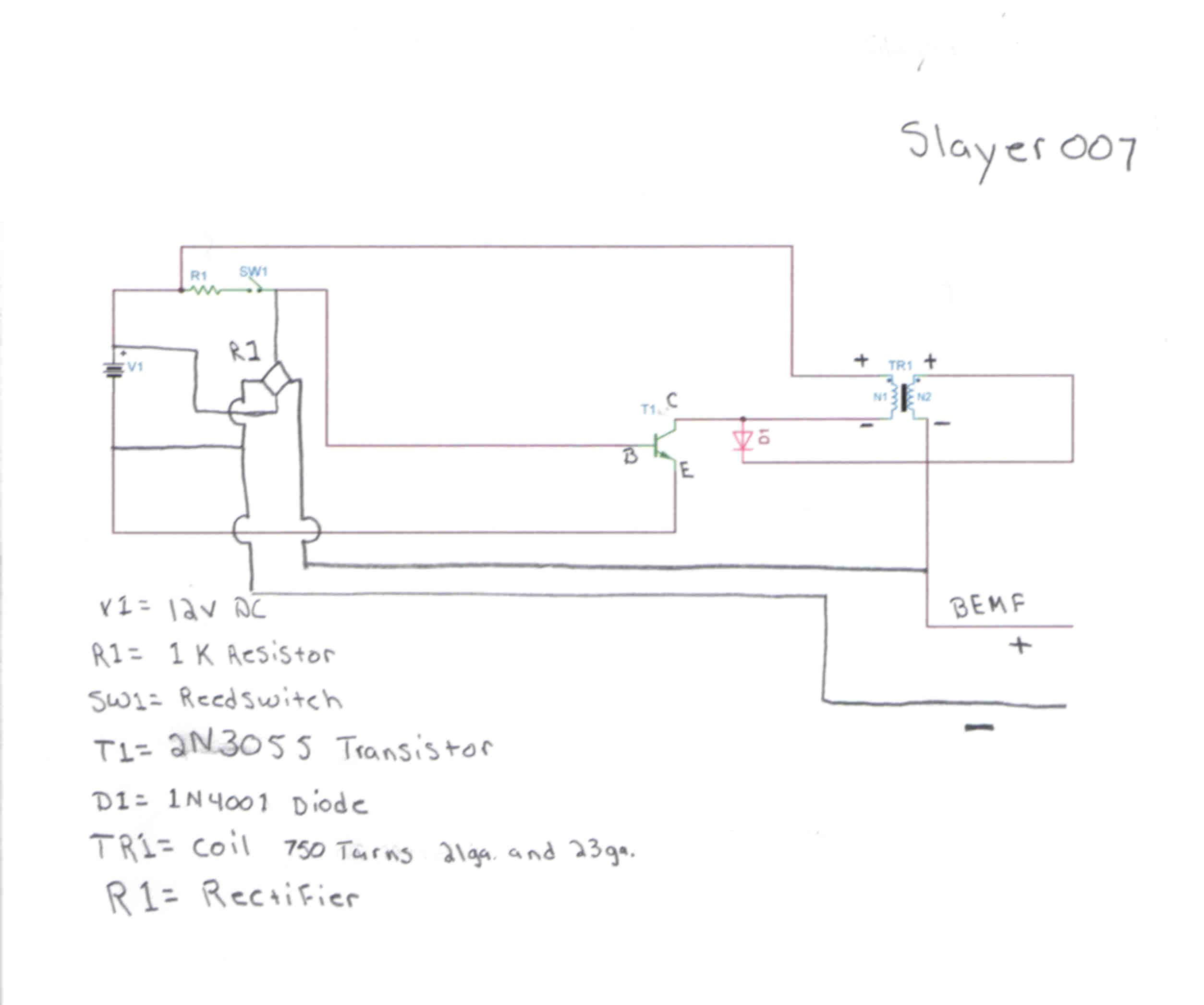

Here is a circuit for it with the parts.
The + of the coil is the start of the coil and the - is the coil ending.
It says 750 turns but I think my coil is closer to 1000 turns.
A smaller coil will allso work fine.
Most or all the parts can be substituted for differant values.
This is just what I fund to work the best so far.
If your charging another big 12v battery the BEMF coming off the second coil winding would go to + on the charge battery.
Then the - for the charge battery can go to eather the - or + of the source battery.
I like to go - to - you get more power and current this way.
But it depends on your coil and setup if it will run that way.
If it stops when you hook up your charge battery this way.
Go - of charge battery to + of source battery.
Dont forget you allso need a small magnet to triger the reed switch.
Put the reed switch in front of your coil then put the small magnet by the reed switch to triger it.
The small magnet is used to make the contacts in the reed switch tutch togeather turning on the coil.
You may have to adjust the reed switch and magnet to get the speed and power you want.
