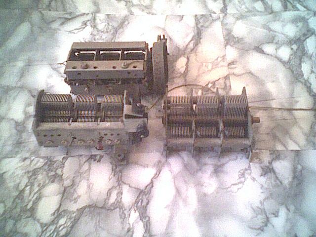

                    Hey men i am using variable capacitors all the time to fine tune the tube.
                    Especially those in the picture below work well.
                    Exept for when there is some dust between the plates, then it produces a violent spark and a loud bang
                    Marcoz.

                      • Variable Air Capacitors as E.V.Gray Components
                        Marcoz.
                        Dear Mr. Marcoz,
                        Nice collection of variable air capacitors you have there.
                        In working with that kind of component, how high of an applied voltage can you work with before you have a breakdown between the plates? I was under the impression that close spacing like that was limited to about 500V. I have seen larger transmitter variable capacitors that have about 0.500" between the plates and they are said to handle up to 5KV. I know that my variable vacuum capacitors only go to 10 KV and thye are usless when attempting to directly tune the parisitic tank capacitance in the secondary of an ignition coil.
                        I understand that plate capacitors have a very low capacitance value - say on the order of 200 pF per section. This means that you can't get very much total capacitance using such a device. Maybe you have come across a topology and/or method that doesn't need a significant amount of capacitance - if so so much the better.
                        Are you able to get results with a variable capacitor in the location where you show your main storage capacitor?, or do you have a fixed capacitor in shunt with it and then use the variable capacitor for fine tuning? Even then a variable capacitor is 4 orders of magnitude smaller than the typical value of storage capacitor found in the Gray/Cole technology (5-12 uF). I hope our window of operation is not so small that a .001% change would make the differance between classical and non-classical operation.
                        Most interesting component variation. I would like to see how one of those uints function in your particular proposed Gray/Cole circuit. A trace of the voltage-current relationship during discharge would be very instructive.
                        Spokane1
