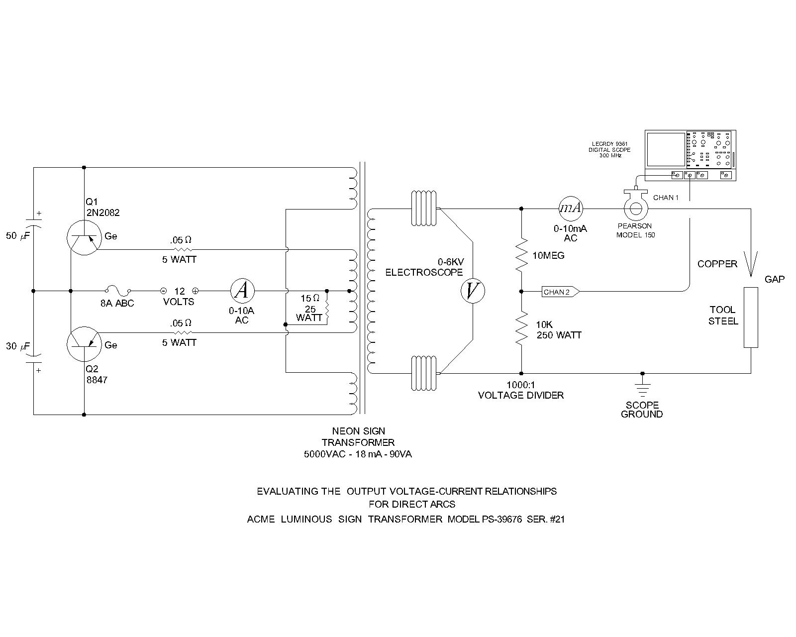

      Here is one instrumentation set up to evaluate the voltage-current performance of a low power NST. In this case I’m putting the 12-5000V Acme Inverter through its paces.
      The approach is to simply connect a series of load resistors to the NST’s output terminals then measure the resulting average voltage and current. The average voltage was evaluated using a 0-6 kV electroscope. The current was measured using a large scale analog amp meter. The resistors used are seven each 80K Ohm 200 Watt 10% units plus one 100K Ohm 200 W.
      The attached graph shows the results. The open circuit voltage was measured with no resistors. The electroscope claims an input resistance of 1,000,000,000,000 Ohms. The short circuit measurement was made directly into the amp meter.
      The scope trace D003 shows the output waveform for the unloaded condition. As you can see the output is not a true square wave for this circuit. As the load increases the waveform changes to a triangle form as shown in trace D010. These scope traces were taken across a 1500 Ohm resistor in series with the rest of the load resistors being used.
      The attached schematic is an improved method using a 1000:1 voltage divider. It took some time to chase down that 100 meg 10 watt resistor.

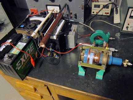

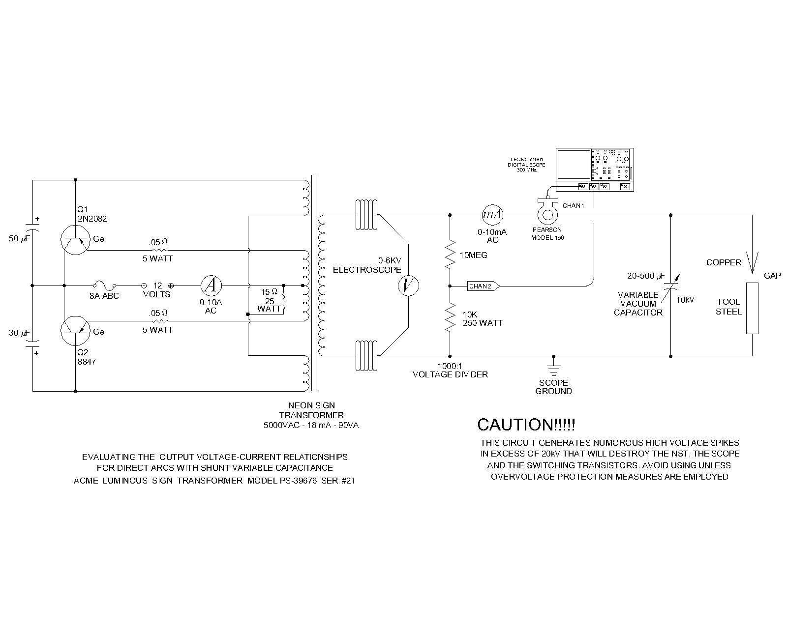

              What happens when some shunt capacitance is added to the NST and a gap? Well, in my case it blew out one of the switching transistors and took the fuse with it. Fortunately the windings seem to have survived. I didn’t even have time to copy a scope trace. It just so happens that I had a replacement transistor on hand or else I would be building a new switching circuit.
              I was using a 10 kV 20-500 pF vacuum variable capacitor. That small of capacitance shouldn’t hurt things since Gray was charging capacitors that we assume were around 5 uF. Well, such is not the case. Now I have a much greater appreciation for what Dr. Tesla calls “Disruptive Discharge”. It appears that a small capacitance is much more dangerous than a large one.
              The change in the mode of operation is simple enough. The shunt capacitor stores energy until it reaches its breakdown potential. Then all of the stored energy is released in a few tenths of a nano second. This action breaks up the steady DC arc into a number of individual discharges. In my setup this is about 7 spikes per half cycle. Let me tell you, these things are wicked. The voltage that I measure with my 1000:1 voltage divider goes completely off the screen at 50V/div (maximum) this equates to pulses in excess of 250 kV, which is a misleading value, but some process is generating some large magnitude spikes.
              I can better appreciate what it was that was toasting my NST transformers in my youth while constructing Hobby Tesla Coils. It seems that modern coilers have come up with measures to combat this sort of thing. The most noticeable procedure is to place the arc in shunt with the NST secondary and then wire the capacitor in series with the coil primary. The theory is that any excessive voltage will cause a breakdown right at the secondary and help protect the NST. Apparently additional measures are needed as well. The common wisdom is the employment of a “Terry Filter” to remove unwanted spikes from getting back to the NST secondary.
              The arcs that are generated in this mode of operation are certainly different than the ones generated directly (Lecture #3). These are much louder and take on the tone of a very raspy buzz that reminds me of an angry hornet. The color of the plasma changes from the violet/magenta to one of cyan (light blue). The arcs are much straighter and appear fatter.
              These arcs look interesting, but I have to protect my NST and my Scope before I can proceed.
              No scope traces were able to be taken for this experiment so you will just have to take my word for it. The Schematic and a couple of photos are attached.

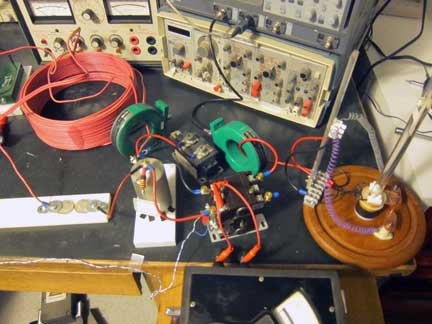

                    I did better than that. I used two (2) each 1964 Silver U.S. Half dollar coins mounted on a strip of Delrin with a 0.050" gap.
                    Using two different spark gaps I charged a 5 uF capacitor to 2700 volts (using the FFF and a diode). Then I discharged the capacitor through my popping coil apparatus. This was done with the copper - tool steel electrode and then with the Silver-Silver electrode.
                    The results were exactly the same +/- 5% between the two approaches.
                    This tells me that the electrode material may have some kind of performace improvement but it is not the central "kernel" to this technology.
                    I suspect that there is some novel circuit topology that we haven't figured out yet that manipulates the arc to do its magic. I'm sure we have all the components used but just don't know how to connect them.

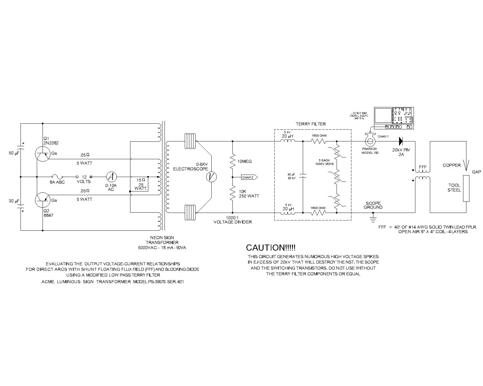

                      • Lecture #5 NST with Diode and FFF
                        Was the Floating Flux Field intended as a means to protect the supply transformer from transient spikes in the Gray technology?
                        Well, one way to find out is to hook it up and see the results.
                        What happens is that the capacitance in the FFF takes the place of the vacuum capacitor used in Lecture #4. So I still end up with these strong spikes. Except now they only take place on the half cycle and not continuously like without the diode.
                        The arcs generated with the FFF look just the same as those generated with the vacuum capacitor, so the effective capacitance of the FFF is on the same order of magnitude as the 20-500 pF capacitor.
                        I suspect there is not enough series inductance in my present FFF to allow it to acts as an effective delay line low pass filter. Adding some magnetic core material might help, but an 8” loop is hard to fill with material. A section of 8” iron well casing (pipe) would fit, but solid iron adds a lot of losses.
                        The experimental Schematic is attached.
                        Trace D001 is the voltage as seen at the transformer.
                        Trace D002 is the current
                        Does anybody have any information about the observed spikes and where they come from?
                        Mark McKay

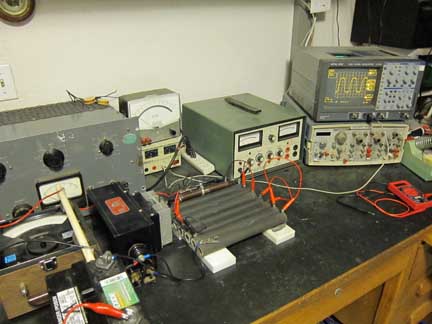

                        • Lecture #6 - NST Terry Filter Performance
                          Lecture #6 – NST and Terry Filter
                          For the last few years Hobby Tesla Coil builders have been using a device called a “Terry Filter” to help protect their NST’s from the damage of disruptive discharges.
                          The classic schematic for this circuit is attached from How Tesla Coils Work. This web site offers a basic explanation of its operation.
                          In applying this circuit to the 12-5000 volt NST inverter we have some challenges. First off there is no center-tap on the secondary. Second there is no earth ground since this technology floats above (or below) ground and is supplied by chemical batteries. So, modifications are in order. Essentially the Terry Filter has four parts to it, each seem to operate independently. Starting from the Main Spark Gap and working back to the NST here is what shook out.
                          Safety spark gap:
                          With no center common only one spark gap can be employed. I choose to use a 5000V Spark Surge Arrestor from Digi-Key. In practice I selected a value that was too low and it shorted out the NST and heated up. The open circuit voltage is around 5.4kV so I can see why this would happen. I suppose I need a Spark Arrestor rated closer to 6 kV. These devices are about $7.50 each. Until my next parts order I shall do with out.
                          Series “Q” spoiling dual Resistors:
                          What I had on hand were 1500 Ohm 100W resistors – close enough for this application.
                          Shunt Capacitance:
                          I’m leery of this one since shunt capacitance is what causes the disruptive discharges in the first place. But, perhaps the added series resistance will help mitigate that problem. The classical Terry Filter uses a series of high voltage poly capacitors in series to achieve an even higher voltage rating. They are balanced by means of 10 Meg resistors. I thought “why bother?” just use a single capacitor rated for the voltage at hand and eliminate all those components. Two 30 KV ceramic door knobs were found in the inventory that together in parallel produced 30 pF. I don’t know what the optimum value is, but some capacitance certainly would help in clipping those spikes. I know there are wide-band frequency issues with which kind of capacitor is used but I didn't dig into that issuse for this first design.
                          Metal Oxide Varistors (MOV):
                          These are straight forward enough. A 1000V model appears to be cost effective and available. I selected 5 each and wired them in series.
                          Added Series Inductance:
                          Before the Terry Filter became popular the only other means used to protect the NST was the addition of air core series inductors. Why air core? Because anything with a core generally couldn’t handle the voltage from a Tesla Coil NST. Here our voltage only goes up to 5.4 kV and hand winding a simple torrid inductor using 5 kV test prod wire is an option. The only problem is that the “fat” wire doesn’t allow many turns, but it should handle the voltage. What I ended up with was two 20 uH 5kV inductors that are installed on each secondary leg just after the NST output. Between the 30 pF capacitor and the two inductors I should have some kind of low pass filter. I didn't do the math to establish the cut-off frequency.
                          Operation:
                          At least the circuit doesn’t impair the operation of the NST and the formation of disruptive arcs, however despite all the added components the spikes are still not eliminated, however they are mitigated somewhat. They do seem to be greatly reduced in the positive polarity but seem just as stron in the negative swing.
                          Scope trace D003 shows the observed voltage at the transformer.
                          Scope trace D005 shows the measured current close to the spark gap
                          Also the Setup Schematic is attached as well.
                          Mark McKay

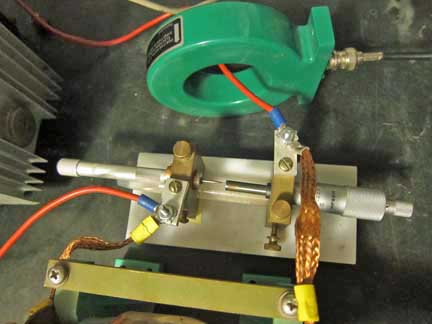

                                Here are some photos of the experimental setup used to evaluate various kinds of metal electrodes.
                                The thought is to charge the capacitor with the current that flows through the arc. Then discharge this stored energy through a small "popping coil" appratus. The conversion efficency is less than 1%, but I'm looking for relative improvement. So far I haven't found any.
