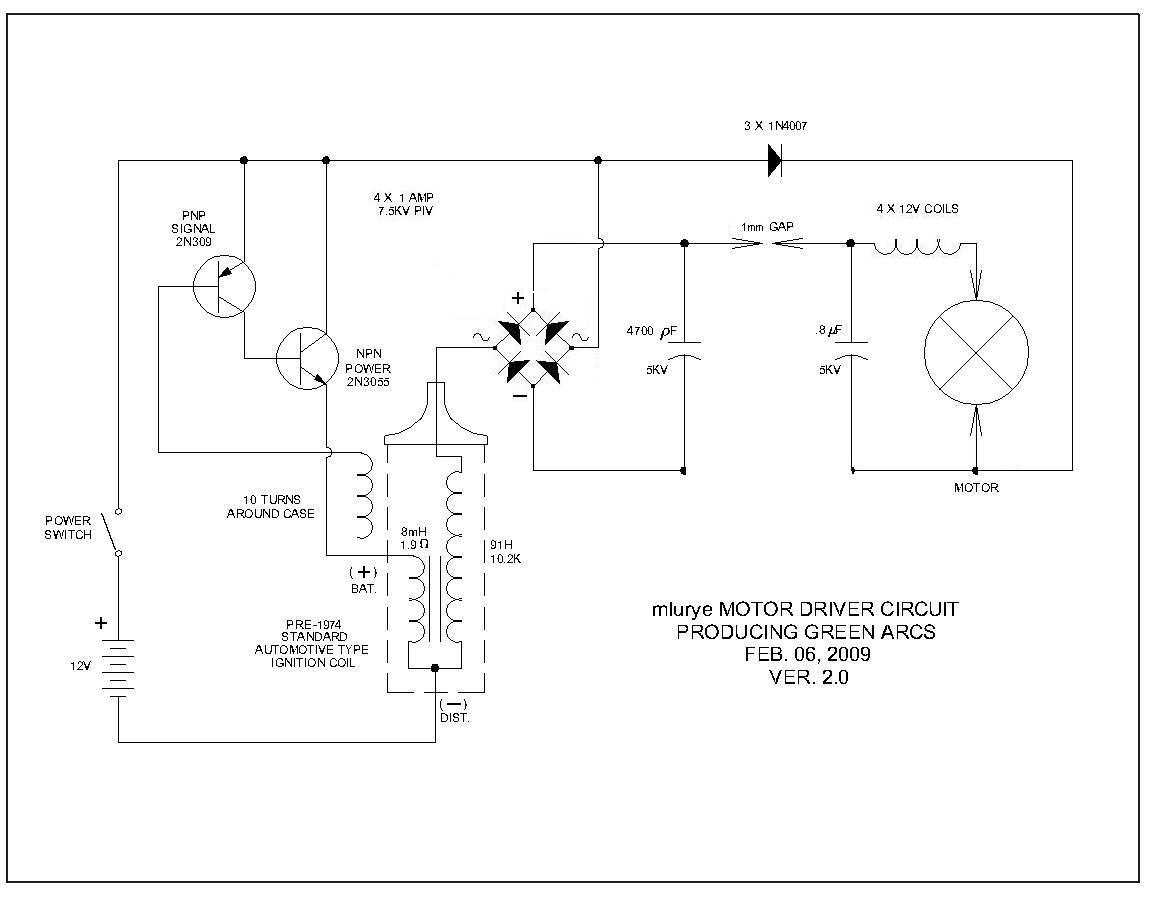

  • Revised mlurye Circuit Drawing Ver. 2.0

    Dear mylurye,
    Here is a revised schematic per your changes. Check my bridge connections. I don't know for sure if you prefer to drive the spark gap with the (+) swing or the (-) swing.
    I know you like to keep your comments brief, but I'm in need of a little more description of what you are using for a motor. Due to technical reasons (land line) I'm unable to review your fine YouTube clips. If I could I wouln't be bothering you with such simple questions.
    If you have a moment could you describe:
    1. The gap distance
    2. size and type of storage battery
    3. proper polarities - I'm sure I've made some mistakes here
    4. History of the circuit if there is any thing to share.
    Thank you in advance, and thanks again for sharing this circuit.
    Mark McKay

    • Mark,
      I did modify schema as it should be.
      I'm not using battery as shown on picture, in my setup I have regulated power supply.
      And there is not much history, I was watching Gray's schema and trying to understand what different components do. And the result is my schema.
      Mike
      • I tried to remove limiting diode and actually it didn't affect performance. And based on my observations discharging cap is not getting fully charged when it's triggered to discharge.
        Am I missing something? Any comments or ideas.
        Mike
        • Originally posted by mlurye View Post
          Mike take a voltage reading across the DC posts of your bridge.

                  • Component Details of mlurye Circuit
                    Mark,
                    Dear mlurye
                    How big of Power Supply are you using? I mean what is its upper limit on amperage? I plan to use a wet cell anyway. But my 2A regualted supply gives different results as compared to my 10A power supply when driving ignition coils.
                    Also could you give me a hint as to what you are using as a motor or inductive load. I feel blind by not being able to see your videos.
                    Dear Aaron,
                    I have your circuits drafted as well, but I will have to wait till I get back to work. AutoCAD 2008 will convert directly to .jpg or .pdf while AutoCAD 2000 (which I have at home) can't seem to convert to anything useful at all.
                    Mark McKay
                    • Mark,
                      Power supply is autotransformer with rectifying bridge and cap. Autotransformer is having 5A fuse. When I'm running my motor Kill-A-Watt is showing 0.4A, 120V. (I'm changing input voltage so Amp draw is changing).
                      My motor is: now I'm using 8 x 12V solenoid coils and motor is disk with neo magnets. See picture.
                      I did corrected schema some more, you can check it above.
                      Are you planning to try this schema?
                      Mike
