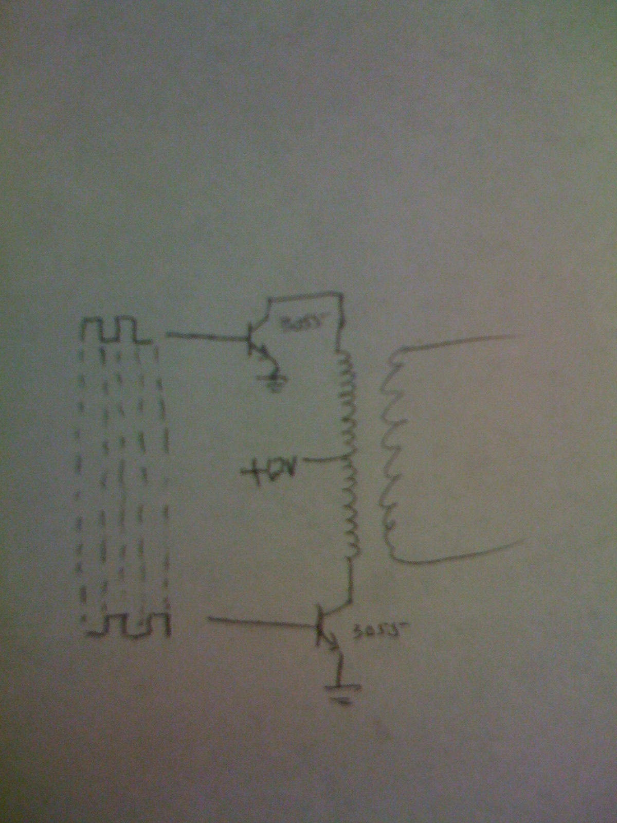

                        Any time I design a switching power supply for my custom car audio, I center tap the primary like Gray did in his schematic and that's what it looks like from that picture. According to the way the schematic is drawn and what I do when I build one, 12v gets fired from say top winding (outside) to the center tap (ground). That gives a rising and then falling output (ie 0 - 12 -0) on the secondary step-up. However, when you fire the 12v on the other winding (outside) to ground, it gives an inverted pulse on the output, falling then rising (0 - -12 - 0). This actually doubles your total voltage swing out vs just using a single primary winding. Just about all high end car audio amp power supply's opperate this way.
                        • Whether he increased the voltage out or decreased it would depend on if mallory either just center tapped the primary or added a extra windings and center tapped them. I do know this, I really have to protect the switching mosfets from voltage spikes when running in this configuration. They will fry in a heartbeat. My supplies and generally amp manufactures' run these around 20kHz PWM regulated. If you "mismatch" the primary with the frequency of the switches, you get major over voltage problems! This could be part of our solution! Im so stupid, overlooking this for so long when it was right in front of me. I cant tell you how long it took me to figure out how to keep those FET's from over heating.
                          This diagram is the basic idea. Mine uses a medium toroid core (about 1.5 - 2" OD), bifilar wound center tapped primary. For experiments, try starting with around 20 turns and running around 4-8kHz. I'll bet you'll get so many voltage spikes it wont even be funny. Be careful though, the FET's or transistors WILL overheat!
                          Now that I think about it even further, didnt Gray mention some sort of having to get some timing issue correct with the switching power supply? I cant remember where I read that but he could have been talking about the timing of the relay's so that the individual waves produced by the switches were synced up. I drew timing lines in my drawing and if the transistors arent switched properly you'll get all kinds of goofy waveforms.
                          Correct me if Im wrong, but the radiant spike occurs on the off side of a square wave. Ok, if that's the case, then if the other switch drives opposite of the first then when the second switch kicks on it would actually amplify or add to the radiant pulse by driving below the 0 volt line. When Ive talked to other EE's on this type of supply they call this effect "ringing" which could be what we need and would almost definately explain the overheating of the switches.
