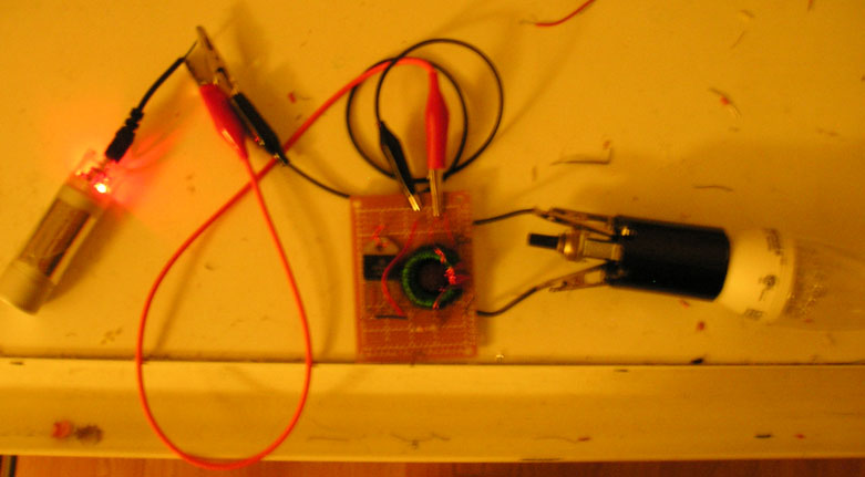

                    Hi Jeanna,
                    Ran more tests today and have had no luck with the un-modified bulb or the modified bulb. In both cases when they battery is on but the socket switch is off, the battery is still actively being drained. I found a neat way to visualize this by using the 1-aa cell phone charger which has a red led indicator light on it which is lit when the battery is activated. As far as I can tell however this isn't related to the bulbs at all, it's just the way the JT works, i.e. as long as there is input from the battery there will be HV on the secondary, regardless of what's connected to the secondary (could be nothing). It's like the circuit itself is the load. You mentioned that "It is only happening with the unmodified LoA bulbs." so you seem to have gotten this working correctly with the switch using a gutted LED bulb...what am I missing?
                    Cheers,
                    kazm
                    • Hmm, I do not know.
                      I have a white lamp that made a video appearance to show how to modify the LoA bulb, and to add a switch into it.
                      It is off most of the time but the battery is in place and whenever I want a center-of-the-kitchen -table light, I turn it on.
                      It has been like this for weeks, so it really does go off.
                      Maybe this is relating to the charger instead of your switch?
                      What is that charger?
                      Somebody like jonny thought the charger was a battery with a joule thief right?
                      If that is true, then you have a toroid in 2 places, and maybe a cap in the charger too?
                      Are those chargers expensive?
                      Anybody game to open one up?
                      I can look in the thrift store next week.
                      This is getting really interesting.
                      I wonder if we can turn this to our advantage?
                      Thanks for doing that test,
                      hmm
                      jeanna
