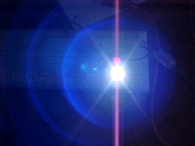

            Hello NickZ and All. Yes I see where you are going And yes I believe the 12 volts could be made to work with the JT and if a type of feedback circuit could be made it would make the run times seem almost endless.When I get the fund's I plan on buying some of the newer higher wattage Led's to test with the JT/12 volt setup.I have looked every where I can think of for the big coils no luck yet! I will Keep Looking After my illness a few months ago I am having to relearn a lot of the things But in a way that's not to bad,At least the electronics's part anyway Tec
            • 12 volt JT working
              Hello All.
              A quick Update I have Hooked up a 12 volt car battery to to a JT circuit I had been running with a 1.5 volt AA Battery I had one 10 mm Led and a red Led to test with.Here are some photo's Tec
              • Originally posted by Tectalabyss View Post
                Hello All.
