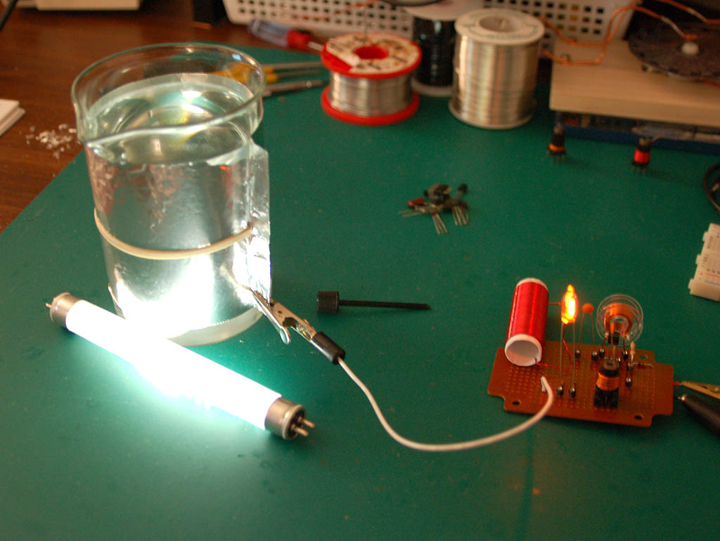

              I took some photos of my setup...As I noted earlier, the two big coils are air except for the L1 which is a variable with a slug.
              Big air coil (L3) is about 25uH and the small one (L2) is 8.5uH. On the other hand the L1 with the slug is adjustable from 1-4uH, or something like that.
              Are the ravings of a lunatic signs of a genius?
                Nice work!
                    Dear Amigo,
                    Very nice setup,, I would like to congratulate you for this nice setup.
                    Could you please let me know which circuit is it exactly?
                    Do you have youtube site and videos?
                    Can you demonstrate the amp and voltage draw as well?
                    Also show wireless power transmission system as Dr. Stiffler did?
                    With gradually increasing the distance and number of receivers?
                    Best Regards,
                    Nuri Temurlenk

                      @Vortex,
                      I remember at one point there was an effort to do some controlled temperature readings and doc built a calorimeter. I believe the videos might still be up on the YT and some details on his page, in the SEC section.
                      Otherwise I do not recall reading on OU thread about any temperature measurements in the ESEC/UBO/Cool White research.
                      @samedsoft,
                      If you look at http://67.76.235.52/e_seg01.htm scroll down to Fig. 34, that's the basic circuit. Rb is 470K and L1-L3 are as I described them; C3 is replaced by the neon bulb and the excitation point is after C2 (before the AV plug).
                      Coils are also described on that page as well, in Table 2 and in Figs. 35, 36.
                      Important for L3 - through trial and error (yeah I built a few L3s) I have determined that proper wire for it is 24 AWG. This is necessary to obtain the needed impedance (~24uH), as per Dr.Stiffler's original measurements for the coil: ID 15mm, length 36mm.
                      I have not done anything beyond the previously mentioned point as I ran out of time (I was doing this during my time off-work). Now that I'm back to work the only real free time I have is during weekends and that's tight as well.
                      But, I'll get there...I just wish I did not have to work for living.
                      Thanks.
