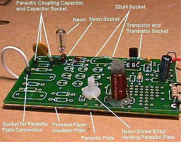

        This is the original SEC15-3 that was the circuit on the Demo PCB's. I was build from common of the shelf components making it as simple as possible to copy and build (caution with construction circuit capacity).
        I will post a current SEC15-8 in a following post.
        • Originally posted by Blue_Serge View Post
          Thank you for pointing me in the right direction. I will try what has been done on overunity.com. Thanks.
          @Blue_Serge
          This is what one looked like if you had purchased one of the PCB's I sold last year. The one in the picture has a parasitic plate that allowed properly tuned circuits to exhibit a CEC>1.
            @Blue_Serge
            This is a SEC15-20 PCB that was available last year.

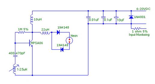

                      • @DrStiffler, thanks for posting the circuit and pics.
                        @amigo, thanks for the scope heads up.
                        @All, I just wanted to add some info on getting a working unit going. Its stripped down to bare essentials and made to run off a battery(s). I've removed the filter for the bench power supply. I run it off 2x12v SLA batteries for 24v, but will work fine at 12v or lower.
                        The basic circuit.
                        http://i197.photobucket.com/albums/a...C15-3088-1.jpg
                        All values are approximated. My LC meter doesn't have a low enough resolution. Roughly +/-1 uH.
                        L1 was loosely wound around the handle of a screwdriver and zip tied.
                        22 Turns 22 gauge magwire enamel coated.
                        http://i197.photobucket.com/albums/a...SEC15-3086.jpg
                        L2 wire seems pretty important. I switched from 26 to 24 gauge wire and I got a beautiful sine wave right off the start from it. Its ballpark to what doc recommends for diameter.
                        24 gauge magwire etc..
                        roughly 1.7cm diameter 3.8 cm length
                        63ish turns.
                        http://i197.photobucket.com/albums/a...C15-3083-2.jpg
                        http://i197.photobucket.com/albums/a...SEC15-3084.jpg
                        Lb is the tunable coil. I bought some of those coil forms the Doc was using on the SEC15-3s but I found them to be limited. I whipped up a tunable coil just out of a bic pen and a slug I had from some PSU I stripped down.
                        22 guage loosely wound and superglued.
                        12 turns or so.
                        http://i197.photobucket.com/albums/a...SEC15-3074.jpg
                        http://i197.photobucket.com/albums/a...C15-3078-1.jpg
                        Been having trouble finding smaller slugs than that. Inductance is what brings up your power consumption in the circuit and those ferrites eat a lot. I've found that setup gives me a nice broad frequency range to work with.
                        I've also used a stripped down 100uH choke I picked up from "the shack". Little bit of sandpaper inside the pen tube and on the ferrite itself and it works about the same.
                        http://i197.photobucket.com/albums/a...C15-3077-1.jpg
                        http://i197.photobucket.com/albums/a...C15-3076-1.jpg
                        http://i197.photobucket.com/albums/a...C15-3080-1.jpg
                        Its recommended that if you put a PCB together to get a socket for the MPSA06. They go pop quite often (at least for me.) Buy more than you think you'll need.
                        First succsessful lighting of the FL tubes on a breadboard. Ignore the amp meter that thing was very wrong. The MPSA06 would have gone up in flames if that was right I think the cap I was using was 22pF so if you don't have a 470 like the circuit says just try different ones.
                        http://i197.photobucket.com/albums/a...oo/SEC15-3.jpg
                        Fully socketed version for plug and play coil building. Diodes on the + and - rails were a misunderstanding on my part. I thought the docs ferrite bead chokes were diodes. Didn't seem to affect the circuit.
                        http://i197.photobucket.com/albums/a...SEC15-3024.jpg
                        http://i197.photobucket.com/albums/a...SEC15-3027.jpg
                        First populated PCB once I had some values to work with from the plug and play. L2 is 26gauge wire, use 24 if you can. I think amigo explained why in earlier in the thread. Transistor is still socketed.
                        http://i197.photobucket.com/albums/a...SEC15-3058.jpg
                        Hope this helps people get started since there seems to be some interest growing.
                        P.S. Look for On Semi's or Fairchilds for MPSA06's.

                            @Mutten
                            There are a couple of ways (simple in fact) to stop the loss of the transistors and to stop the loss of transistor Beta over time. Additionally there is a simple fix to stabilize frequency. Most important is the input (source voltage) and as I stated the SEC effect can be seem as low as a couple volts. I have run the simple 15 as high as 24 volts, but that is walking on glass. My preferred and the voltage used on Generation Two exciters as well as ESEC is 16 or 18 volts.
                            The high voltage generated is just to high above 18 and in addition to blowing the CB junction the heat generation is always positive and CEC will be <70%. I hinted at how you can see what is doing the damage by monitoring both the + and - rails at the same time and looking for a difference, you will always see a big offset when your transistor blows.
                            With you running totally from battery and if I read correctly you removed the rail filters?, you will find the batteries to be very RF Hot. In fact when properly tuned you could do something similar to what Aromaz did in one of his videos where he could light a neon off the insulating surface of the battery. You can wind a simple sniffer coil, about the same as your L2 and connect it to your scope (through the 10X probe) and use it to sniff around your circuit, coils and battery. This way you will get a far better picture than any direct connect that I have always objected to unless you have some very good and expensive probes, which in fact still upset the circuit somewhat.
                            The sniffer coil and a simple AV Plug and White LED as shown on a few of my videos will also show you more about what is taking place.
                            I do not recommend running without power rail filtering, even with the batteries. Also another way to approach tuning is with a AM radio or a SW that will cover up to say 12MHz. You can find some very interesting things this way, and use caution as you can cause problems with people around you (electronics, watches, pacemakers etc.).
                            You ask about sending me a PM, I did not use the OU forum mail and prefer not to use this one either, email is the best way and what I stay with. If you expect info that is not published in public you will have to do like many others have and setup your email with a certificate.
