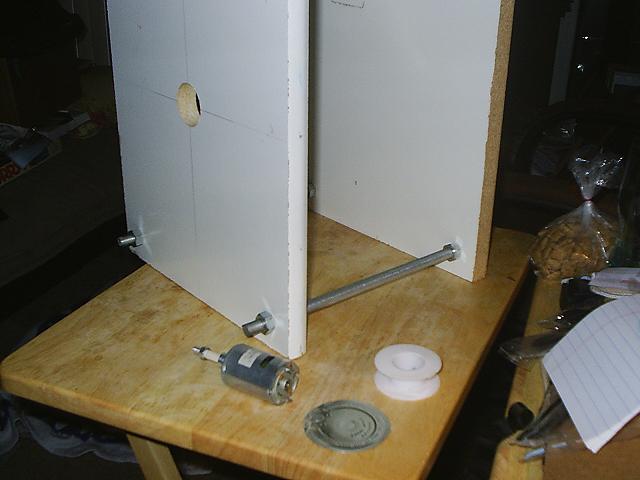

      Hi Bruce, to be exact the vinyl record is 11 7/8" diameter X 1/16" thick, the cad drawing is in scale. Yes the record could fit 8 but it may not give the snapping effect, testing would prove that out, but since i only have 4 tin plate discs so far from tin cans i will only be mounting 4, meaning 2 on one side at 180 degrees and 2 on the other side for starters and one coil pair. So definitely no washers or holes in the shielding material here. Here's a pic of the main structure and a few of the parts i will be using. That's an RS-540SH motor in the pic.

                  Hi folks, Here's a pic of my progress thus far. I need to make another coil and make a couple of aluminum shaft pieces to make sure the vinyl record stays flat when rotating. Of course as i eat more lasagna and give dog food to my dog i will then have more tin can tops to use on the vinyl record, lol. The magnet wire is 24 gauge.
                  Tyson

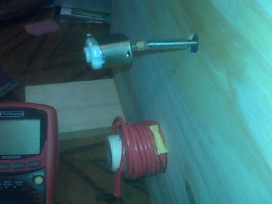

                      Hi folks, i spun up the generator and i'm not seeing any voltage generated, though i dont have the rotor very close to the coils, if it was im sure id see some voltage. So something is different in my setup compared to Smith's apparently. Though I was thinking about my original setup with the bolt used for a core in the coils and a bolt used on the rotor and why it was more effective. I think it worked because the flux density was decreased or shifted in the bolt core when the rotor bolt approached. Ant thoughts on why this isn't working are welcome.

                              Hi Bruce, Nice to hear from you and congratulations on your promotion. Yes I have been running many little tests to figure things out here. The coils are 24 gauge and each coil is about 5.5 ohms. I made a couple of tests with a coil with bolt core and found that if the tin plate is not passed close to the coil itself irregardless of whether there is a ferromagnetic core or not, little voltage is generated. So it seems that the permanent magnets field at the back of the coil attracts to the tin plate and the tin plate needs to be as close as possible to the coil face to generate the most voltage. This then explains why , if wiring the coils to create opposite polarities and orienting the permanent magnets with opposite polarities facing rotor, there is less output generated from coils. At least in the my configuration when using 2 coil pairs and magnets at back of coils it appears that the tin plates need a field built up on them for best output. Now some have said that the tin plate or bolt as in my old setup was just becoming a magnet itself and generating the voltage, which seems to be the case, however i still think based on past tests that as long as its not fully saturated that lentz will not cause a slow down when current is drawn out. I also noticed that when both magnets are oriented to repel towards rotor that the least drag is produced compared to opposite poles facing rotor. As far as does a smaller or bigger piece of tin make a difference on the rotor, it seems so far that it probably only needs to have enough permeability so as not to saturate for the given field strength its exposed to and that would need to include any lentz fields created so as to not saturate.
                              That's a few of my recent observations.
