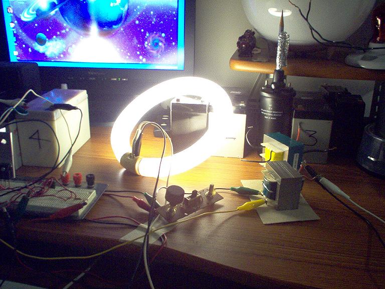

        Hi folks, here is a pic of the halo bulb running at 300 milliamps @ 12volts. That is a 22W bulb. Pulse frequency is between 1.5Khz-2Khz. You can see the transformer used on the right and the one behind it works well also. I am not using the capture method here.
        peace love light
        Tyson

          @Tyson---That amount of light at those numbers will work great for me! I changed the cap in my circuit already to push the frequency up to the 2Khz range and got better brighness. The next step is to get the right transformer.
          The capture setup that I showed in the video appears to be actually working. The 1.5 volt battery packs are charging up and the light is staying on. I have the amp draw way down at between 60 and 100mA. It is hard to tell if the system would run just as long or not if I just used the extra 8 AAs when the first set ran out. My rough calculations put the run time at around 2 days if I did it that way. As I write this the system has been running 29 hours. If it makes it past 48 hours then things get real interesting. I swap the batteries every 6 to 12 hrs. when I get around to it.
          Lidmotor
