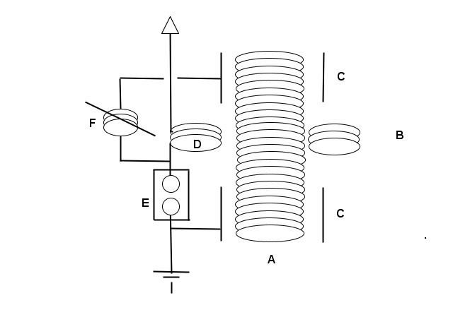

                      This is my first contender to meet the bill, It is a Self Oscillating Solenoid.
                      The parts are as follows:
                      A - single layer tesla style solenoid
                      B - Primary coil with signal generator attatched
                      C - Capacitive plates (arranged as a ring to fit around solenoid)
                      D - Exciter Coil
                      E - Neon, or other impedance gap
                      F - Adjustable inductor or capacitor or both to make a phase shifting arrangement.
                      Here is the operation!
                      The signal generator B is set to a resonant mode such that solenoid A reaches 1.5 or higher its fundamental frequency. This ensures at least one magnetic peak (about the primary and exciter coil) and two electrical peaks at each end of the solenoid.
                      The solenoid driven in this mode will have two electrical maxima located on opposite ends of the solenoid, (this is where optical physics plays a large role)
                      This causes a potential gradient which passes THROUGH the solenoid which is PARALLEL to the magnetic gradient, (NOT OUT OF PHASE 90 Degrees) So that any curent developed through this parallel potential gradient creates a magnetic component with is 90 degrees out of phase with the magnetic potential of the solenoid itself, hence the induced current does not affect the inducing current per lenz law. (this is an interesting side note, not required for operation)
                      Also, the potential maxima radiate a potential field per the inverse squared law, and in doing so we place capacitive pick up plates within this field (plates marked C)
                      Each Capacitive plate is connected to one end of an impedance, in this case a neon. A second exciter coil is placed within in series with the neon.
                      Operation is as follows. Signal generator places solenoid in resonance. Solenoid creates virtual electrical maxima on each end. Per capacitive action, a charge is built upon the capacitive pickup plates which ionizes the neon bulb. This causes a great increase in conductivity, which allows a current (maybe 12v or so) to flow through the neon which could not before. As the solenoid reverses its polarity passing through a zero point, the ionization will cease to occur, shutting the neon off.
                      Here the neon acts like a triggered spark gap. It is triggered by the electro-optical properties of the solenoid in question.
                      In order for this scheme to work the exciter coil in series with the neon must be in phase with the signal generator which started the chain reaction. This is the reason for the phase adjuster. At this point, once the solenoid is triggering itself, the signal generator may be removed from the picture.
                      Now you are left with a single solenoid, a driving potential and a self firing impedance gap.
                      It is self oscillating, requires lower voltages for operation, (no required 1000v+ initial voltages, 12 - 50v is enough) and it can be adjusted very easily.
                      P.S. Placing a mechanical push button switch across the neon can serve as a one push pulse which can start the chain reaction, possibly doing away with the signal generator.
                        Edit,
                        The frequency felt by the neon by the capacitive plates will be 2x the frquency of oscillation in that each half of the cycle will cause ionization of the gap, so half wave rectification will have to be thrown in to make it impinge at the correct time. Or one could substitute a frequency halving mechanism.
                        Also, loose coupling is required on the capacitive pickup plates, if it is tight, the energy used in this circuit will dampen the oscillations of the resonating solenoid. Loose coupling is an area of study in and of itself, there are specific geometric ratios which lend to a "one way" effect on transference of energy between coupled elements which can be described in predictable ways.
