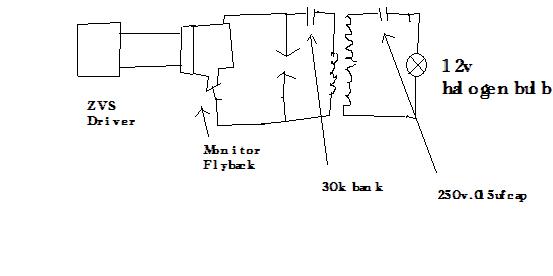

          • Originally posted by JohnStone View Post
            Hi Guruji,
            confusing - bank of capacitors at L1?
            Usually small capacitors are suffitient in order to get resonance with L2. At my setupt it was exactly 400 pF.
            Another question: serial or parallel spark gap?
            Schematic will be helful.
            Yes my bank is on L1 cause I need high voltage with my ZVS driver although I have low microfarads on t
            Parallel spark gap to driver as shown
            Posted schematic
            Hi Guruji, you need to determine the resonant frequency of L2 while it is
            attached to it's load if it has one, then you need to determine the L1 tank
            capacitor value, you can do that like this- just say your L2 resonant
            frequency is 200 Khz and your L1 has 30 uH inductance, then to make the
            primary resonant at 200 Khz you would need about 21110 pF or 21.11 nF so
            (use 22 nF), if the primary has 60 uH you would need about 10.55 nF (use 11nF)
            to make it resonant at 200 Khz. If adding the correct capacitance to the L1
            tank reduces the spark frequency too much then you will need either,- more input power , more
            turns in the primary ( to lessen the capacitance needed ), less turns in the
            secondary ( to lessen the capacitance needed), or maybe making the spark
            gap narrower to increase the discharge frequency could work for you.

            If the cap size is right the spark gap won't fire at the wrong time, so once you
            have the correct cap in place then all you need to do is get the discharge
            frequency high enough to maintain the tank oscillations enough to keep the L2
            oscillating continuously. If the cap you are adding is the correct size then I
            think you either need to reduce the spark gap distance or increase input power, if
            that's not possible then you might need to take action to alter the setup so
            that the L1 cap only need be small.
            Having the primary 1/4 the length of the secondary will not guarantee
            resonance, nor will any other arbitrary method in my opinion, the L1 tank cap
            at the least will need to be sized to produce together with the L1 (primary coil) a Tank
            oscillation frequency to match the resonant frequency of the L2 (secondary).
            P.S. If you use magnets to quench the spark gap that may increase the
            breakdown voltage of a given gap width. Air flowing through the gap will
            increase the breakdown voltage of a given gap quite a bit so if there is wind it
            might need to be kept out of the spark gap especially if it is intermittent like
            from a pedestal fan on rotate.
            Thanks for this info Farmhand yes I will try to find the resonant frequency of coils. The thing is that I saw vids lighting bulbs even out of resonance.
