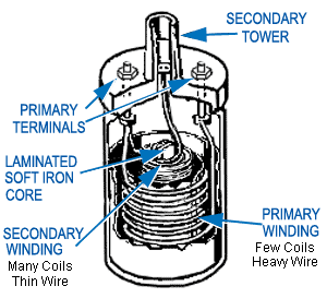

                  • standard ignition coil
                    Here is some info on standard automotive ignition coil.
                    The ignition coil is nothing more that an electrical transformer. It contains both primary and secondary winding circuits. The coil primary winding contains 100 to 150 turns of heavy copper wire. This wire must be insulated so that the voltage does not jump from loop to loop, shorting it out. If this happened, it could not create the primary magnetic field that is required. The primary circuit wire goes into the coil through the positive terminal, loops around the primary windings, then exits through the negative terminal.
                    The coil secondary winding circuit contains 15,000 to 30,000 turns of fine copper wire, which also must be insulated from each other. The secondary windings sit inside the loops of the primary windings. To further increase the coils magnetic field the windings are wrapped around a soft iron core. To withstand the heat of the current flow, the coil is filled with oil which helps keep it cool.
                    The ignition coil is the heart of the ignition system. As current flows through the coil a strong magnetic field is built up. When the current is shut off, the collapse of this magnetic field to the secondary windings induces a high voltage which is released through the large center terminal. This voltage is then directed to the spark plugs through the distributor.
                    Rick

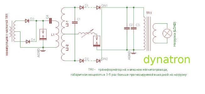

                      • Originally posted by dyatronn View Post
                        Всем привет, вы меня конечно, извините.....
                        но, Зилано дурит Вас......, я в английцском языке не силен, но у зелины нет и ничего*быть не может, - это все обман.!!!! !!!!!!
                        Это поиск лохов....
                        Dynatron

                            • Oh, she's back, i'll get first row
                              Originally posted by vidbid View Post
                              Anyone can make any accusation, but without evidence, that is all it is.
                              And "without evidence" all her statements just a farce.
                              Or we ask too much? Just show your "using" device and teach us as much as you wish, we all ears.
                              Changing others schematic don't do any good.
