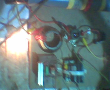

        I've did the toroid setup to my ZVS driver via SG. Bulb lit and got hot as you've said Zilano showing that it's hot electricity . My problem is when I hooked the toroid on the secondary of Don circuit to a 2KV MO cap with bleeder removed nothing.
        Wondering why
          Wondering why
          congrats lighting up ur first bulb!
          can u specify the circuit? how u connected Don coil with ur zvs driver and spark gap?
          from images am not able to decipher clearly.

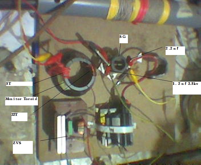

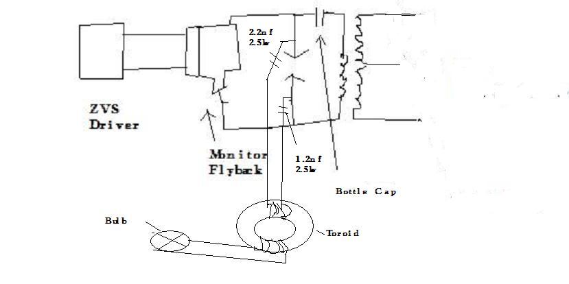

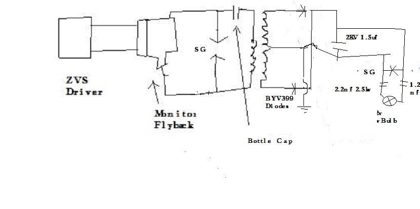

              • Setup
                Thanks Zilano for guidance. This is my setup and schematics. Would like help on the secondary side if you have a clue Zilano?

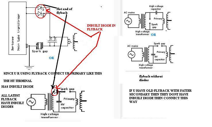

                    i see it as u have wrongly connected ur spark gap and capacitor. connect as Don bertonee way but not Tesla Way as u have Diode in built in ur Flyback.
                    SEE IMAGE BELOW
                    I see U HAVE LATEST FLYBACK WITH INBUILT DIODE CONNECT ACCORDINGLY AS SHOWN IN FIGURE.
                    ITS BEST TO CONNECT THE FLYBACK WITH DON WAY AS SHOWN IN BERTONEE CIRCUIT BELOW. JUST REMEMBER
                    THE SPARK IS BETWEEN GROUND PIN AND LC CAP COMBINATION.
                    U CAN USE OTHER METHOD ALSO BELOW BERTONEE FIG. WHERE HT OF FLYBACK IS CONNECTED TO CAP THEN SPARKED TO COIL.
                    HOPE U GET IT WOT I MEANT IF NOT SHOOT UR QUERY.
