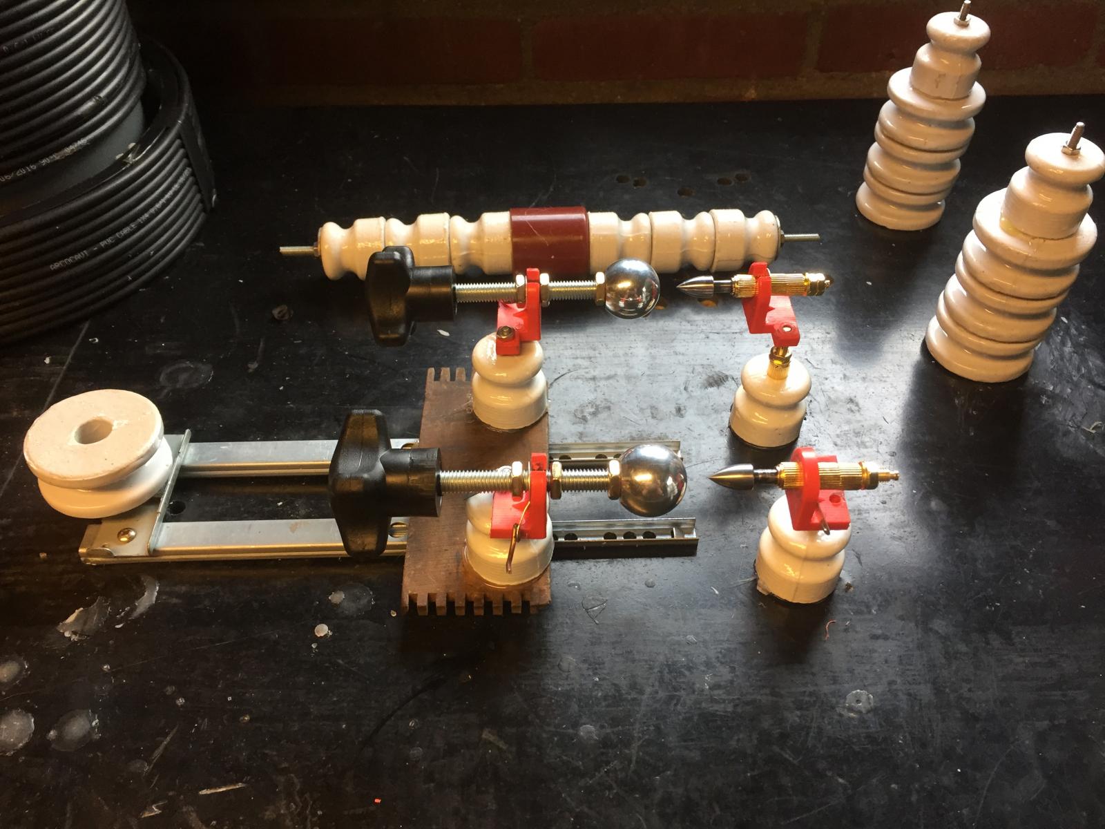

Looking good, I like those stand-off insulators! I'm going to have to improve the insulation on my test rig considerably, at 26KV there are small leaks happening all over the place. I can only imagine how problematic it's going to be to get 100KV and higher....
