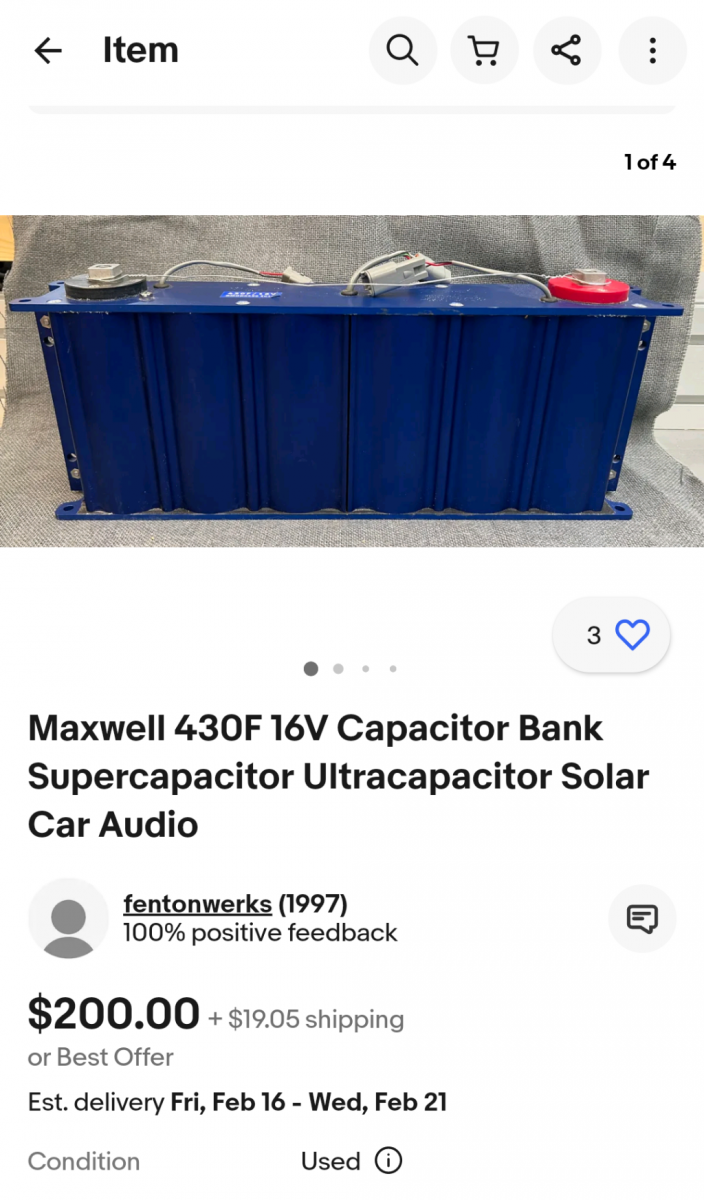

    About condensers, the variant suggested above, to the garage master who has made a self-propelled generator will be unavailable and to buy a set of condensers with capacity of at least 10 Farad is a very expensive event.
    10 Farad is 10000000 mkF if to take a condenser 35V/10000 mkF you need 1000 pcs one piece costs about 2.5-3 dollars, that is 2500-3000 dolars
    Ordinary starting battery 65 A*h has a cost in the range of 72-156 USD. At the same time at start-up there is no need to charge the battery, unlike condenser batteries, which still need to be assembled into a proper assembly.
    276312984820 is the item number for eBay of this:
    For a few dollars more you can purchase the capacitor which I showed.

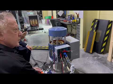

                                I don't think the technology is not working! The question is how they are trying to make it work (unfortunately there is no sufficient demonstration of the possibilities). Any synchronous electromagnetic generator does not tolerate reactive sources (reverse energy) that are present in the circuit with the loads that the generator provides power to. The Holcomb generator is no exception. This system has a very serious output voltage regulation problem. I have explained these difficulties to two replicators of a similar system (via transistor control and collector-brush assembly). So the best solution is to use it as a charger. The second is an accurate calculation of the system - magnetic circuit. Variant of the design, which is demonstrated in the video I have doubts. Rather in the variant from the video with capacitors, Holcomb tries to make an asynchronous generator, in the design of which there is little confidence, for the solid-state variant (in the end it will be a transformer). A proper Holcomb solid-state machine will be more expensive, even with full equipment, compared to an electric generator driven by an internal combustion engine of similar power. It is clear that they tried to make the construction cheaper, but I think in vain.

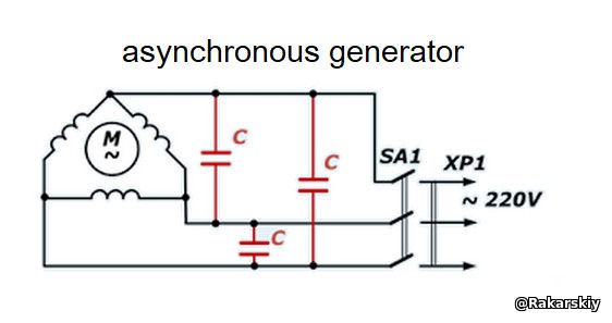

                                The asynchronous generator
                                The asynchronous generator works in the braking mode: the rotor rotates in the same direction as the stator, but its speed is initially higher. The rotational speed of the magnetic field always remains unchanged and only the rotor speed can be controlled. Such generators are not vulnerable to short circuits and are well protected against external influences (dust, low temperature, moisture, etc.).
                                The disadvantages of the asynchronous generator can be called the mandatory presence of capacitors and the dependence of the output current frequency on the stability of the diesel or petrol engine. At the same time, the cost of such a device is lower than synchronous, but it is used less often. Asynchronous generators are recommended for connection of devices that do not require high starting voltage and are resistant to voltage fluctuations.
                                Induction generators use a squirrel cage rotor (the same as in an induction motor).
                                If my assumptions are correct, they are wasting their time. In synchronous generators, the magnetic field of excitation has a constant component. It does not matter whether it is a permanent magnet or a controlled electromagnet, the result must be a constant looped magnetic flux.
