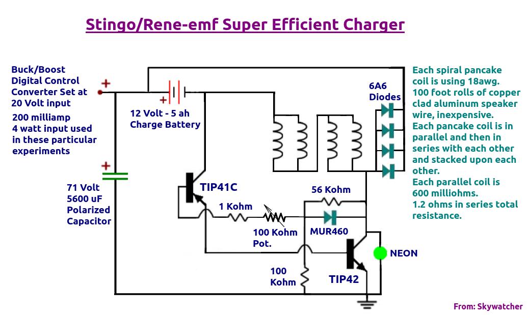

    Hi all, thought i would start a fresh thread about this oscillator charger, which is the one that gives very sharp pulses at around 1% duty cycle.
    I've been making experiments, to discover what coils and wiring format, give this charger the most efficiency.
    Upon various tests, i observed charge/discharge cycle efficiencies from 80% to 90% to a little over 100%, when trying different wiring setups, while making controlled charge and discharge cycles, to observe watt/hours used for both charge and discharge cycles.
    Here is the nice thing about it, i've been using a 12 volt - 5 ah sealed lead acid battery for testing, which is only 50% efficient at absorbing charge, at least that seems to be the claims about lead acid batteries and charging to 15.50 volts peak under charge, which is even less efficient, because charging lead acid towards the end of charge becomes even less efficient.
    That being the case, this setup is doing very well.
    I've been testing many iterations of coil setups.

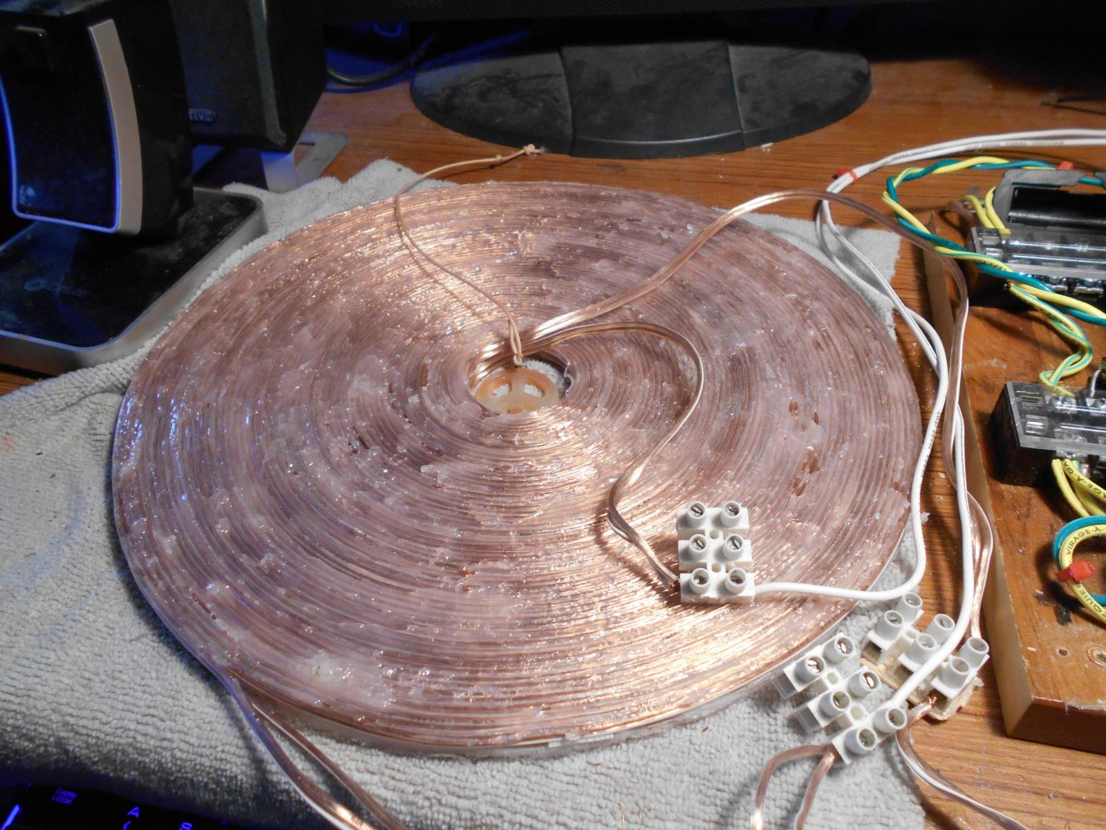

    The best one so far, is using 18awg. speaker wire 100 foot rolls, i'm using the cheaper speaker wire, which is copper clad aluminum.
    I made 2 coils so far, each in spiral pancake coil format and wound the easier way, with the speaker wire pair wound vertically, for ease of winding, then hot glued to hold it together.
    The pancake coils are stacked on top of each other for better coupling.
    Each speaker wire pair pancake coil, is in parallel and then in series with each other.
    This gives each pancake coil a resistance of 600 milliohms, because the speaker wires are in parallel, then the pancake coils are wired in series to give 1.2 ohms total resistance.
    Each 18awg. speaker wire pancake coil in parallel, which effectively makes it into a 15 awg. wire, instead of 18awg..

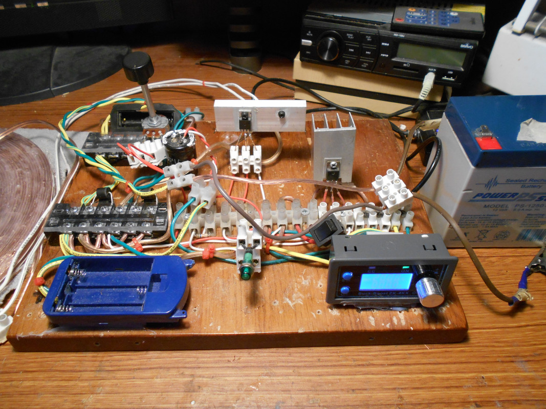

    I'm using a buck/boost converter with digital readout, so i can see and control what is being input to the charger circuit.
    Then using a digital charger, to observe and control exact amp hours being discharged.
    I will post pictures of the setup and schematics when i get a chance to work on that.
    All comments welcome.

          Hi all, I've been making more tests and realized, that the c20 charge rate needs to be observed, when charging lead acid.
          As too low of output, as set by the potentiometer, will be less efficient and too much amperage output, will be inefficient at being absorbed by lead acid batteries.
          I checked the input amps compared to output amps at different settings of potentiometer.
          At 200 milliamps input, the output averages around 270 milliamps, which is close to c20 charge rate.
          At 300 milliamps input, the output is 410 milliamps, this is too high to be absorbed efficiently by this 5ah battery.
          This is why the 200 milliamp input, has been the most efficient so far, at around 102%, based upon charge/discharge watt/hours used.
          Also remember, lead acid is only 50% efficient at absorbing charge and worse from 90-100% of charge.
          The next tests, will involve adding more pancake coils, a third one will be added and compared with similar output levels, to observe for any efficiency gains.
          peace love light

              Hi straggl3r, thanks for the information.
              I also added a photoflash cap., directly across the charge battery connections.
              I salvaged it sometime ago, from one of those throw away cameras, i had on hand.
              It's 100-150uF electrolytic-low esr capacitor.
              This addition, may help charge absorption and more charge efficiency.
              peace love light
