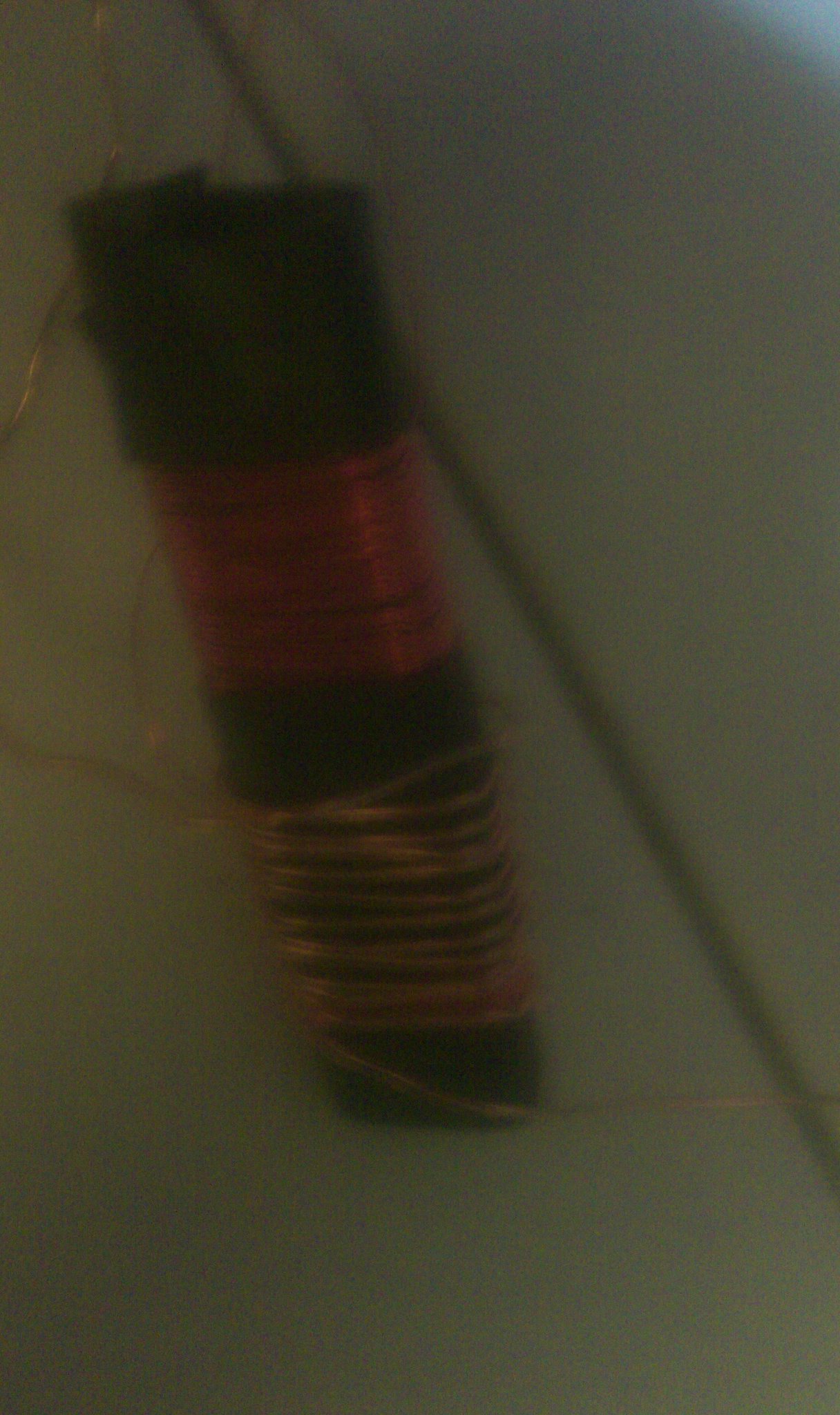

                          • Originally posted by altrez View Post
                            I think something is still wrong. It will not light a neon at all. And the LED on the AV plug is dim.
                            Yes. Something is wrong. Post a photo of your coil.
                            Have you tried reversing the L2 leads? If you are still using a 2N2222 you should eventually try to get a bigger transistor and use a heat sink. I suggest using a cell phone charger to do your tuning, that will limit the current going into the transistor.

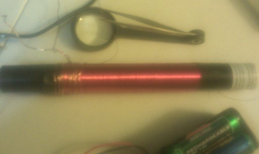

                            EDIT: This is video of a 900 turn coil. You should be about the same.
                            YouTube - Slayer exciter circuit - 1 AA battery

                                WOW your coil is like 1000 times bigger then my little coil. Thats awesome But my coil is around 1200 wraps? and its small I posted a pic.
