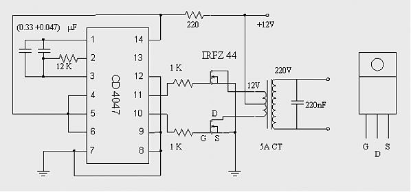

                            Hi,
                            This is my first post here.
                            One thing I can tell you for sure, inverters bought at the store will not work or maybe just for few seconds and will end up in smoke.The waves created by the SG and the coils interfers with the electronics in a standard inverter. You can build yourself an inverter that will work fine here.All you need is a normal transformer with 2x12v output and use it in reverse. You can drive it easy with a flip-flop circuit.I built a powerful one by cutting the high voltage part in a MOT then I had to wind 14+14 turns.Works great driving it with TL494Cn and irf540. For more power add more transistors in parallel for every channel.Make sure the circuit is going to be shilded with some aluminium foil.
                            Success!

                                i will buy that transistors tomorrow, can you share the flip flop circuit your r using?
                                the shield is for the High Frequencys not interfere with the transistors?
                                sory to bother
                                kings regards, love & light
                                I have been looking to find the diagram for you and no success at this time... but I found another one I have used some time ago and is much more simple and the components are easier to get.Transistors can be irf 530, buz11, irf3205, any of them but don't mix them. Use at least 2 transistors in parallel for each channel, more transistors = more power, it depends of the transformer you have too.Time to go to bed now for me...
